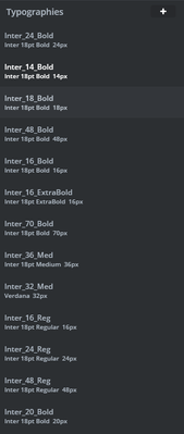

Hi @Osman SOYKURT , thanks for your message!
For this particular project we have 12 different typographies, bitmap and all use Bpp = 4.
All texts we use an specifique font called Inter.
