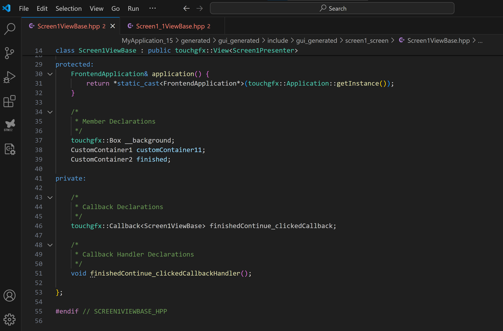

There are two custom containers in the project.
  • CustomContainer1 contains one item called finished.
  • CustomContainer2 contains one item (name irrelevant).
Both containers are added to the same view.
  • CustomContainer2 with name finished (!)
  • CustomContainer1 (name irrelevant, but contains an item called finished).
For CustomContainer2 I create an interaction (clicked callback).
When I open the project (screen1 is selected) and click generate -> No callback generated.
When I select the Screen1_1 view in the designer and generate -> Callback generated.
The cause must be the duplicate name finished, but there is no warning or error or anything.
Hello @EmbDev ,
Thank you for providing the example. But, I'm afraid to say despite multiple attempts while using different versions of TouchGFX, and carefully following your instructions, I couldn't replicate the issue. All the required callbacks and functions were generated correctly.
Callbacks generated correctlyCallbacks generated correctly
The point you made about CustomContainer2 and an element in CustomContainer1 having the same names causing this issue can't be true because they are different objects, and there should be a distinction between them. Additionally, the code generation in TouchGFX is independent of the Screen you are viewing in the TouchGFX Designer. That's why I'm quite confused about your statement that selecting a different screen in the Designer results in different generated code.
I would like to see if other users can run the example and test if it happens for them or not.

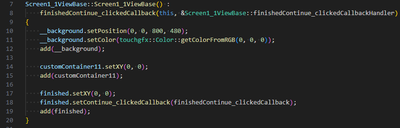

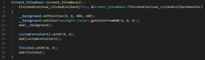

Thanks for checking, I completely agree with you that those should be separate objects and there should be no link with the designer. However, somehow there seems to be..
Could you check one more time, as I wasn't clear enough about 'No Callback generated'.
What I actually meant is in the Screen1_1ViewBase.cpp the line to register a callback is missing in the constructor.
Opened the project in the designer and clicked generate code:
Selected Screen1_1 in the designer and clicked generate code:
After selecting the Screen1_1 you have to re-open the project in the designer to reproduce the bug again.
It fails to generate the register callback until you select the Screen1_1 view.
