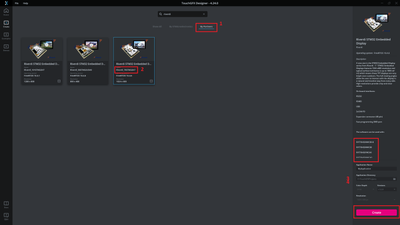

2024-08-09 2:26 AM
As a rule of thumb, always use the latest versions if you can. So for TouchGFX, STM32CubeMX, STM32CubeIDE, etc.
Since you use a Riverdi board, here are the steps to be able to flash your design on your board:
Then you can import the GUI you previously created by clicking on "Edit" => "Import" => "GUI".
If you have done those steps and you get the error messages mentioning flushline and DecompressorRGB, simply open your folder, open the STM32CubeMX file (.ioc) and click on "Generate code" (make sure to use the correct toolchain such as STM32CubeIDE for STM32CubeIDE or TouchGFX Designer).
Then you can flash again and the issue will be gone.
If this comment solves your problem, I invite you to select it as "best answer".

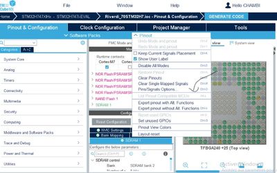

2024-08-08 1:17 AM - edited 2024-08-08 1:24 AM
Hello @Aziz ,
If you created your project from TouchGFX Designer by selecting your board+display combo, then you can try to open the STM32CubeMX project (.ioc file) and click again on "Generate code" (make sure to have the right toolchain selected [STM32CubeIDE for TouchGFX Designer] and do NOT generate under root).
Can you tell us what board+display you are using?

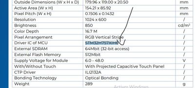

2024-08-08 6:58 AM
the display i use is Riverdi_70STM32H7 i have riverdi 7"
2024-08-09 2:26 AM
Regards,
