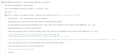

I am new to touchgfx and looking to implement something where a array of structure containing name and other parameters to display. I need to display parameters on selection of the names displayed.
I have a   created a container and able to update the parameter names to the textarea of scrollist as in picture.
Now i need to implement a way where user can select any one Preset name and those corresponding parameters should load to the respective area. as in image attached.
Just let me know the way to do it will try out things as suggested.

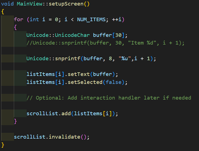

Here is one of the samples I am trying to do, though the content of the scroll list is more but just for our discussion and experiments created a sample.
Will Discuss on it further once you are available.
Hello @Shiv09 ,
In this example, you have 50 items and it does not crash like previously.
What is this code supposed to do?

Hello @GaetanGodart ,
Yes this is new example I am trying to do experiments on.
Yes I need 50 Elements in the scrolllist, so added it.
In the above example I am trying to update the text in each element eg its name. hence have added it.

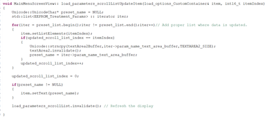

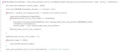

I share the snippets of the actual code which is crashing, hope it will be helpful.

I will recommand you to debug your project and check the value of index and size, when it hits the assert.
