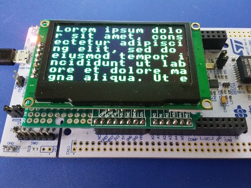

What LCD, some generic 162 LCD ? Surely lots of examples for those.
But those are rather 1990's plenty of nice OLED displays now driven via I2C, using SSD-1306/1309, code examples for those easy enough to locate.
