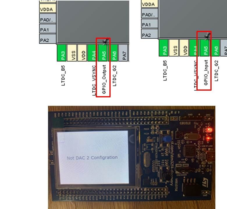

I tried many ways. However, the DAC 2 channel output is not active.
  • The problem starts the commuity issue 'Undefined reference to 'HAL_RTC_Init' problem'
  • I tried the method you suggested, buf nothing displayed on the LCD.
  • So, I finished the integration of TouchGFX( version 4.17.0 ) and STM32CubeIDE( 1.8.0 ) by comparing different project files( STM32F7 series ).
  • The integration was done in the following way.

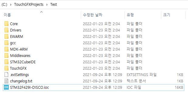

  1. In TouchGFX( ver. 4.17.0 ), Make project and generate code ( ex. Proeject name is Test )0693W00000JMxW1QAL.jpg
    1. ​Open the directory C:\TouchGFXProjects\Test and rename the STM32F429I_DISCO_REV_E01.ioc -> STM32F249I-DISCO.ioc.0693W00000JMxWkQAL.jpg

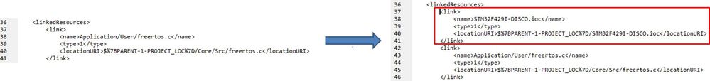

    2. Open the directory C:\TouchGFXProjects\Test\STM32CubeIDE, open the .project file and add the code in the area marked with a red square and save code.0693W00000JMxYMQA1.jpg

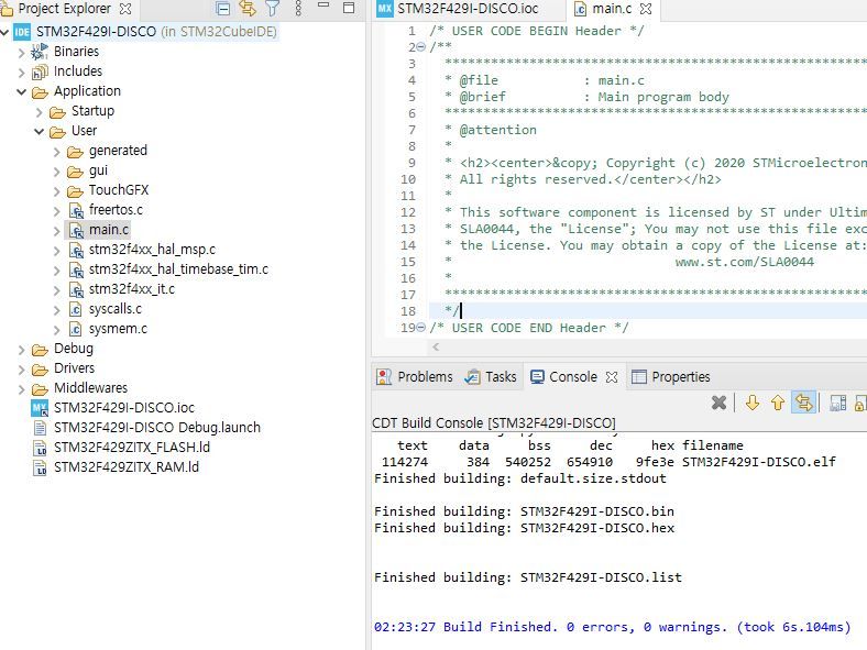

    3. Execute the .project file and open STM32F429I-DISCO.ioc file in STM32CubeIDE Project Explorer.

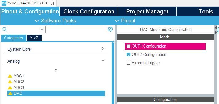

    4. In STM32F429-DISCO.ioc file, check the DAC OUT2 Configuration and generate code.( The DAC Channel 2 is GPIO number PA5. )0693W00000JMxZAQA1.jpg
    5. Build the proejct successfully, and Run the project on the STM32F429I-discovery board.0693W00000JMxa3QAD.jpg

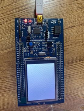

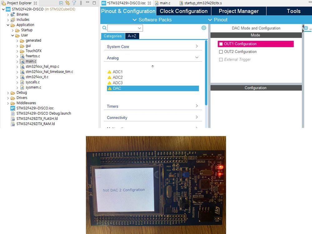

  • However, If you build the PA5 pin without any settings, it will output the LCD.
  • 0693W00000JMxbVQAT.jpgAnd, after building the PA5 with GPIO IN/OUT, downloading the firmware shows the LCD.
  • I want to use PA5 as DAC OUT.
  • Could you help me how to use PA5 as DAC OUT?
  • Or could you tell me the integration of TouchGFX and STM32CubeIDE which can use PA5 as DAC OUT?

MM..1
Chief III
Your method for add ioc to project is little...
But when your LCD show nothing i recommend debug it why...
Hello, How do I add an .ioc file to STM32CubeIDE project?
