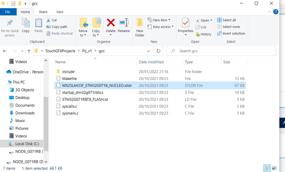

FTrom
Hi
the CubeProgrammer has the file stldr  I don´t know if there was also before

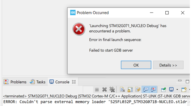

0693W00000JMloZQAT.pngI follow your advice but I have still the same issue. I got it is diifficult to understand the issue, so i try to give you so much infot as possible. Following step by step. I have also attached a file word with the images.
  1. Create a prj with TouchGFX called Prj_v1 (it is just a white screen with a button)
  2. Generated the code
  3. I open with STM32CubeMX the file .ioc in Prj_v1 /TouchGFX
  4. Check the library TouchGFX are loaded
  5. with STM32CubeMX generate the code
  6. Open the project generated by STM32CubeMX with STM32CubeIDE 1.8.0
  7. Compile
  8. close STM32CubeIDE 1.8.0
  9. move the MX25L6433F_STM32G071B_NUCLEO.stldr in the folder C:\ST\STM32CubeIDE_1.8.0\STM32CubeIDE\plugins\com.st.stm32cube.ide.mcu.externaltools.cubeprogrammer.win32_2.0.100.202110141430\tools\bin\ExternalLoader
  10. open again STM32CubeIDE 1.8.0
  11. compile
Thanks in advance
Fausto

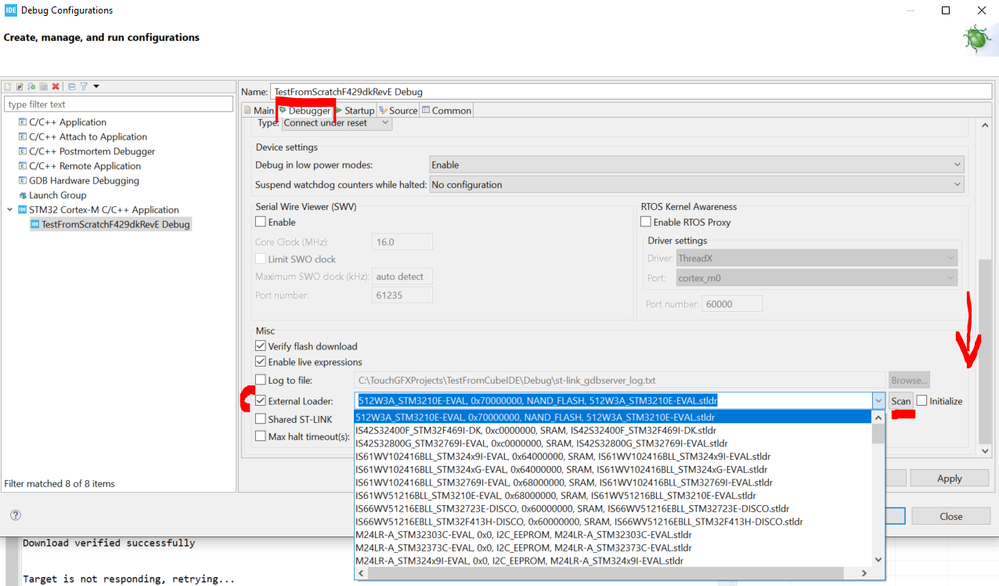

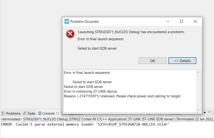

You can see in the error message at the bottom of your last picture that the external loader used is the S25FL032P and not the MX25L6433F. So you have properly added the MX25L6433F to your repository but you have not actually set your project to use it. To do so, click on either the arrow next to the debug or run options and go to the "Debug Configurations" or "Run Configurations" menus (in the following picture I go to the debug one).0693W00000JMo15QAD.pngWithin that new view, go to the Debugger tab, scroll down to the bottom and check the external loader used. If nothing is shown press the scan option and go through the list to select the correct version.
/Romain
FTrom

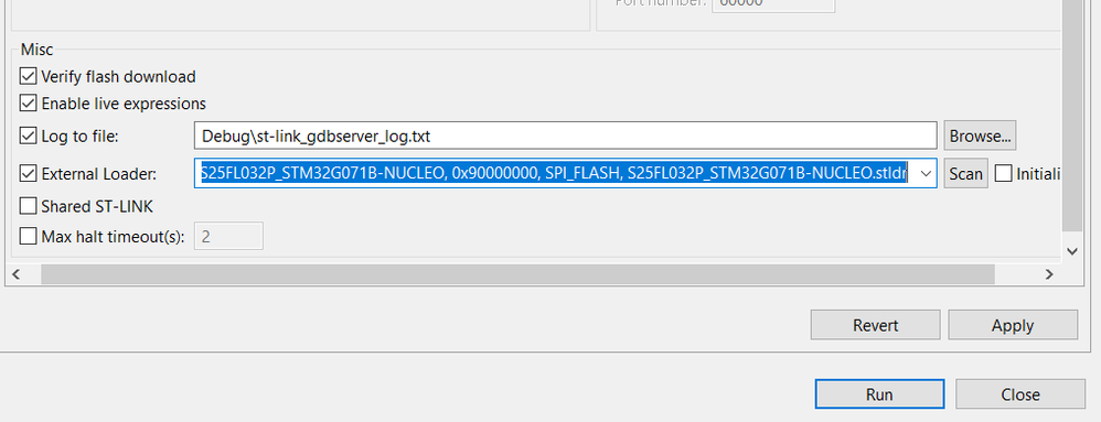

I have followed your instruction and the S25FL032P_STM32G071B-NUCLEO.stldr was already selected.0693W00000JMw7KQAT.pngI did anyway a scan again-
When I compile it , I have the same error.

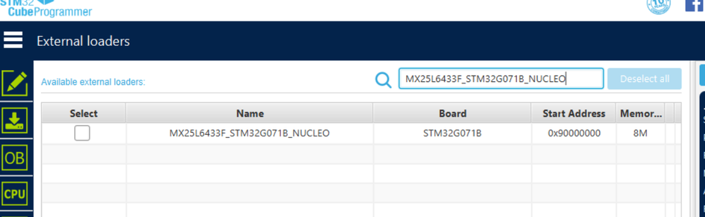

0693W00000JMw7yQAD.pngin the prject folder there is MX25L6433F_STM32G071B_NUCLEO.stldr. Should I change it manually with S25FL032P_STM32G071B-NUCLEO.stldr ?
And where could I find this file?
For my curiosity I have selected MX25L6433F to see what could happen given that in my project folder i have only that....and something strange happened:

 is it correct all of these instructions?
Fausto

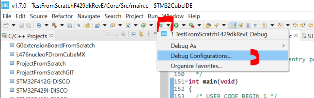

You misunderstood my message. You should use the MX25L6433F_STM32G071B_NUCLEO.stldr and not S25FL032P_STM32G071B-NUCLEO.stldr which was the one set in your project.
I'm a bit confused about the "switching context" messages but it might be something expected.
/Romain
