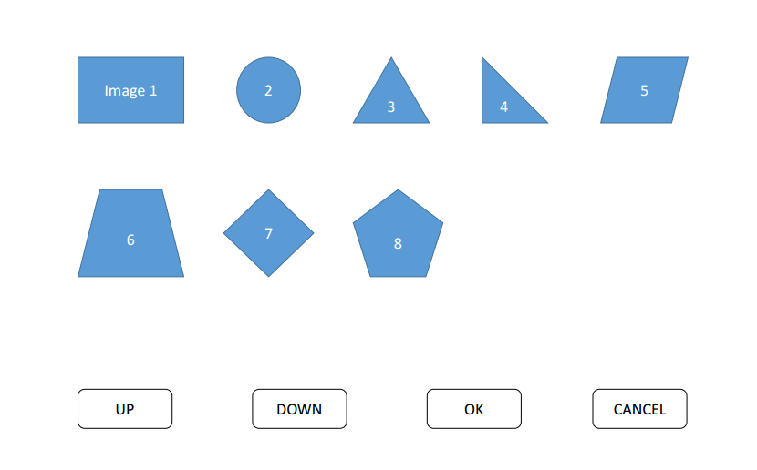

I want design 1 dialog like that:
When mapping external button to ''UP'', ''DOWN'' touch button,image will be marked or hight light.
Image 1-8 are .png files, not is button.
How to do that?
Set image to button? Or convert image to stream data .dta, ''iconviewer'' will control these image?
Can you send for me examples with 2 image random?
Thanks.

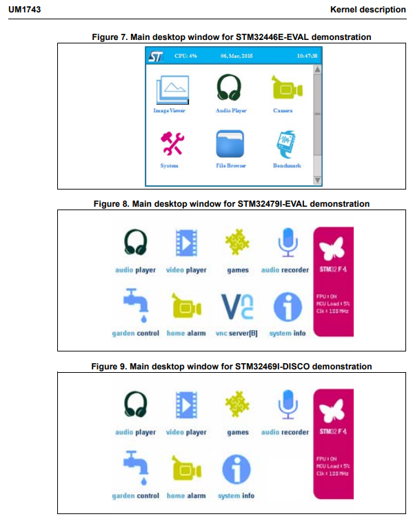

My idea like that, I have some icon image. Example circle and rectangle is image .png file (.dta files).
''I have just update circle.png, rectangle.png , .dta, .c to link:
https://drive.google.com/drive/folders/1dHgIe4uFZUElhIBmTC-IFxvM4C0D2oIs?ogsrc=32
It is picture that i sent for you!
Below:
rectangle icon as 'image viewer'.
circle icon as 'Audio Players' or ''camera'...
up/down external button to go 'image viewer', 'audio player', 'camera'...
ok
external button to choice/select icon to next funtion/dialog.
Can you create example for me again, please?
Thank you!
Posted on July 14, 2018 at 03:59
Dear you,

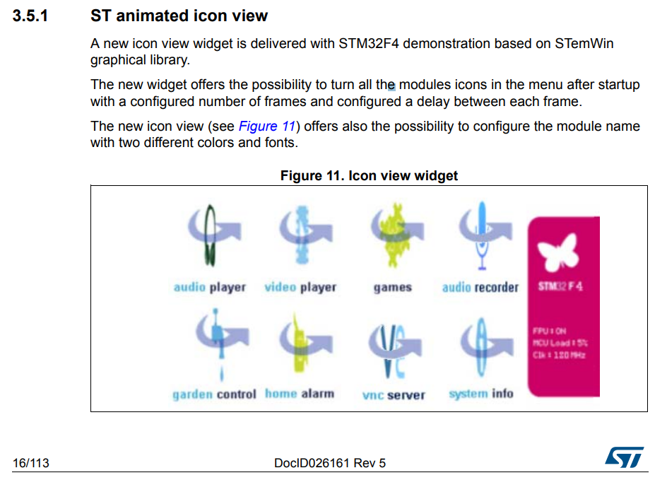

Here is picture with many icon image, 'Browser' is selecting.
http://emwin.ir/wp-content/uploads/2017/02/emWin_Widget_Iconview_1.gif
