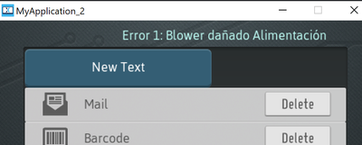

Hello to all ,
I am wanting to display a text that changes over time what it says, this works fine but for some reason the letters with tilde or the Ñ does not appear.
I put a picture of how I set the typography and how it is shown badly written in the simulation.
in “wildcard characters” I added áéíóúÁÉÍÓÚñÑ and in “wildcard ragne” I put ,Á-Ú,á-ú,ñ-Ñ but it did not work.
why does this problem occur?
Error 1: Blower dañado
Error 6: Alimentación insuficiente (it was cut off by the scrollablecontainer, it doesn't matter)
Error 12: Unidad no respondía

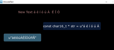

Hi @Maximiliano
Prefix the string with 'u'
 Unicode::snprintf(texto_errorBuffer, TEXTO_ERROR_SIZE, "%s",  u"Ñá");
 texto_error.invalidate()
I attached example project.

Hello @MM..1  thank you for replying.
the fault is in the buffered text.
I also tried putting directly a ñ or a letter with tilde and it fails too.
I don't know if I understood correctly, but is your capture of a text without buffer?
 Unicode::snprintf(texto_errorBuffer, TEXTO_ERROR_SIZE, "%s",  "Ñá");
 texto_error.invalidate();
Un ejemplo del uso que le estoy dando es:

Strings in your source files is in UTF8 , then cant be used directly... why you dont read solution?
Hi @Maximiliano
Hello @ferro
Thank you very much! I am happy that this alone can work without having to make major modifications to the code.
Just to clarify for anyone else reading this:
with wildcard ranges:
a-z,A-Z,0-9,Á-Ú,á-ú,ñ-Ñ
it's ok, you don't need to put in wildcard characters.
