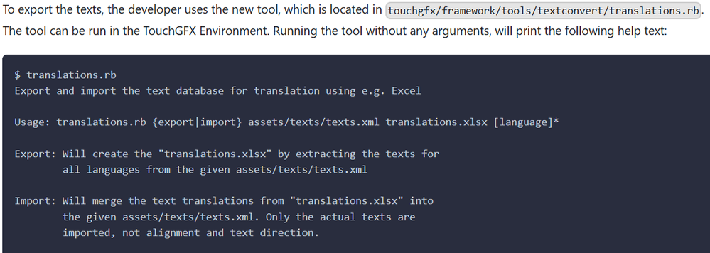

the documentation says
"The tool [translations.rb] can be run in the TouchGFX Environment."
What is meant by "TouchGFX Environment" ?
What does the dollar $ sign represent ? Is it a ruby interpreter ? Or some TouchGFX command line tool ?

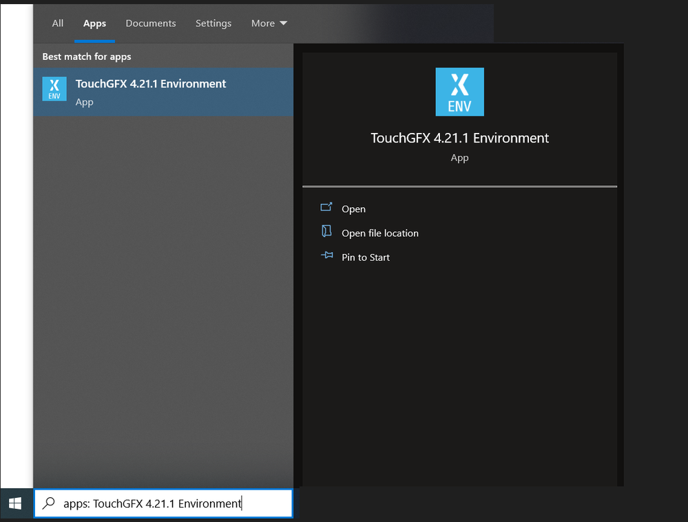

TouchGFX Environment is a command line tool provided when you install TouchGFX Designer. It does include a Ruby interpreter so that developers can use the scripts of framework.
It can be found in your installation path at : \env\MinGW\msys\1.0\msys.bat

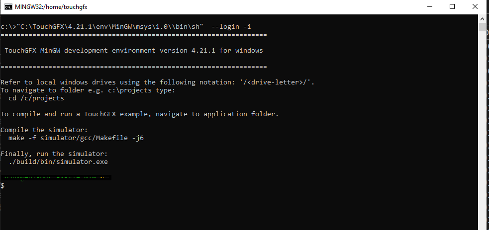

Crystal clear, Thanks.
This helped to understand how to run it from command line
"C:\TouchGFX\4.21.1\env\MinGW\msys\1.0\\bin\sh"  --login -i
