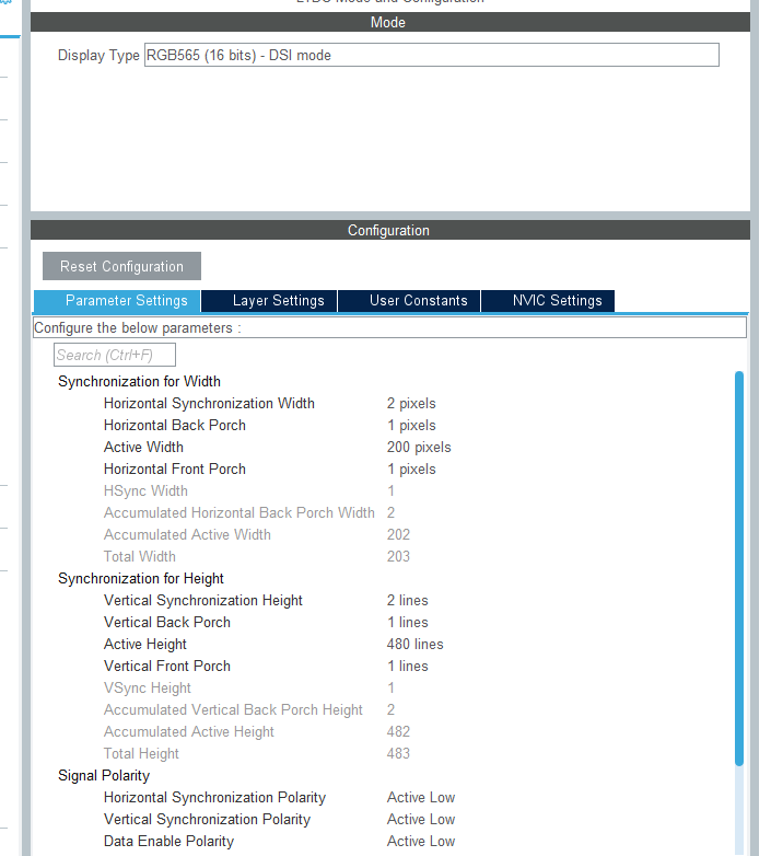

I receive yesterday the board from Mouser. After powering up I notice that the display did not start with the usual demo as my other new STM boards starts. Then I try to load it from TouchGFX app but still the screen was completely black. I try with separate simple "blink" project and everything was normal. I'm not sure for this board, but i believe that in the moment of powering up the display's back light should blink for moment. Correct me if I'm wrong because this display do not blink.The other think that I notice is that the code that is generated from TouchGFX is suspicious - see attached photo. The resolution of the display is 800x480 according to the datasheet. I'm not sure that it matters but my board is with blue solder mask.
I would like to ask, if it's possible, some one that have working code for this board to share it with me.
I want to try to verify where is the problem. From the software or HW part.

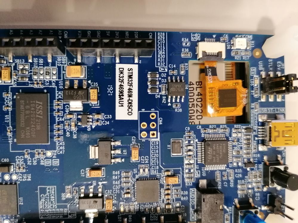

Check out the board user manual for component replacement due to obsolescence such as displays. The demo binary may work only on the original board.

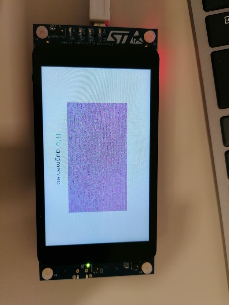

Thank you for the replays! I found that the problem is not in the HW part. With the official binaries the display at least give some signs of live. From what I understand till now the different revisions had a different displays, touch controllers etc. I am little disappointed but I hope that soon there will be software solution for this issue. I made some photos of the board just for reference. MB1189-F469NIH6-B08 A2223008510693W00000WK1s7QAD.jpg0693W00000WK1rnQAD.jpg
Please checkout the post above yours, it contains the software for this revision of the board.

I saw that you have the same revision as mine. With your binary the result was again dark screen. What model is your display?

Ok, strange also tried to reupload the elf file on my Discovery and now it does not work..
But when I open the TouchGFX project (B08 branch) and click on Run Target it still works.

Sorry about that, it is still really hard to check in the right files for a TouchGFX project.
I just added the missing files, now with the latest git revision everything should work (did a clean checkout myself).
