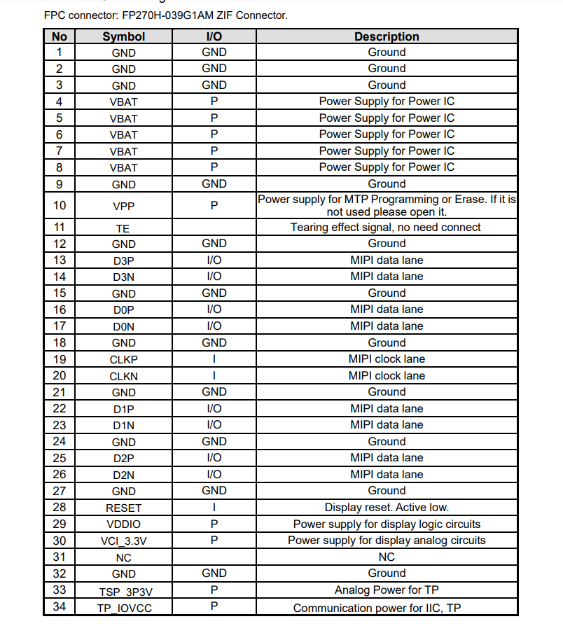

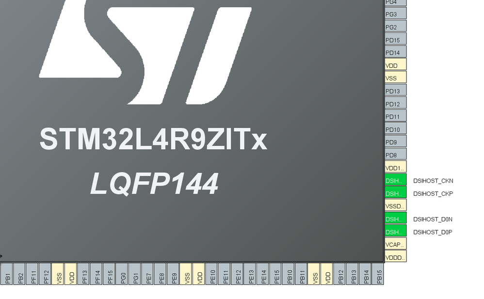

0693W00000APOhxQAH.png0693W00000APOjeQAH.pngI Have only one lane but my Display has 4 lanes I don't know how to connect them both
Please help me to interface the display with MCU
Well you're only going to able to connect the CLK/DATA pairs (CLKP/N, D0P/N), and then either strap the display in single lane mode, or configure the display side controller into the same. Basically a need to RTFM until the doubt arrives at understanding.
Obviously going to limit display resolution, colour depth and bandwidth..

The STM32L4R9ZITx (LQFP144) only has one data line for DSI. Some other chips in this family have 2, but none of them have 4.
Single Lane @ 500 Mbps, figure 60 Hz 16bpp to around 700x700 (or about 500K pixels)
1-lane provides for data and command/control, most controllers start with this, but provide for expanded modes via configuration
