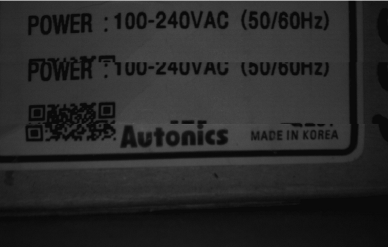

I'm trying to get an image from a camera with a resolution of 752x480.
In this case, the size (752 * 480) / 4 = 90240 exceeds the maximum DMA transfer length 65535.
And I get a broken image:
1/4 of the image is duplicated.

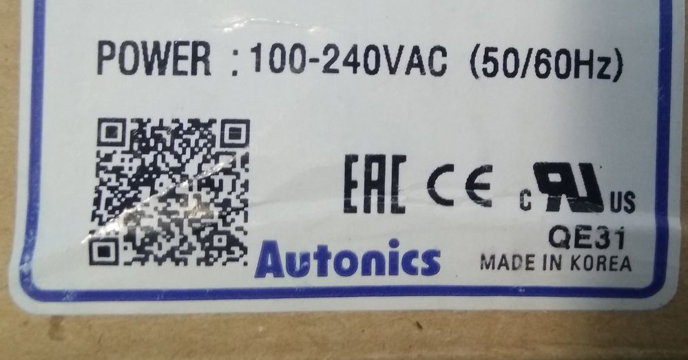

Original image:0690X00000AAPgGQAX.jpg
DMA MemToMem initialization:

Does DCMI in STM32L4R7 support this resolution?
If so, what could be the problem?

This is very confusing.
JLall
Hi @MMele​ ,
I'm suffering some issues as well with a sensor generating 300kB images.
The symptom on my side is that the DCMI DMA ends up in Overrun error after the first transfer is complete.
Have you got some success with your implementation in the end?
If so, can you explain what solved the issue?
Thanks in advance,
JC
JLall
Doing my own response, I have found that the DMA channel used for DCMI should be set in circular mode in CubeMX.
I was focusing on the generated code and it was looking like everything was set properly. That was a wrong assumption.
