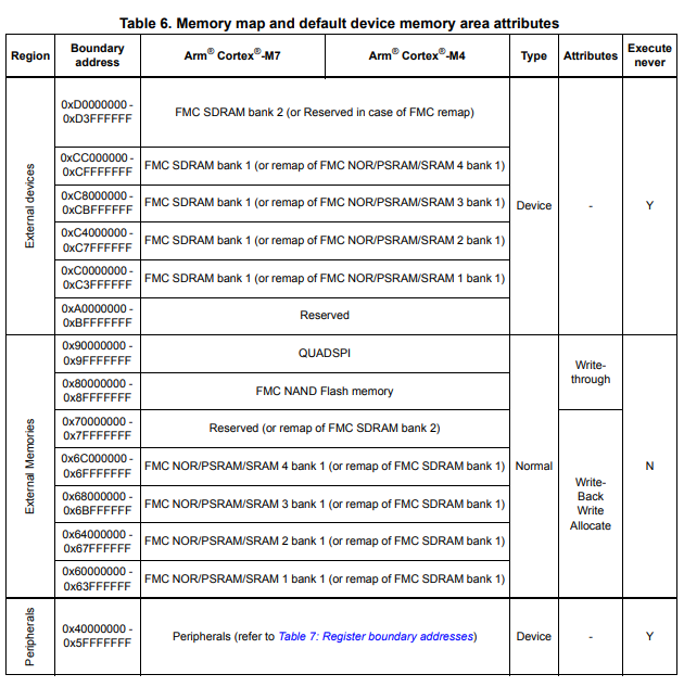

If I go into the CubeMX settings and set the framebuffer strategy to "Double Buffer" and the buffer location to "By Allocation", I can see my screen after flashing, but it is frozen. According to TouchGFXGeneratedHAL.cpp the video RGB buffer (1,152 Mbyte for 800 x 480 x 3 bytes) is located at 0xd0000000 in SDRAM and the framebuffer is placed at 0xd0119400 right after the video buffer. The pointers are set accordingly in the TouchGFXGeneratedHAL::initialise() by calling setFrameBufferStartAddresses((void*)frameBuf, (void*)(frameBuf + sizeof(frameBuf) / (sizeof(uint32_t) * 2)), (void*)0);.

sorry for the late reply. Here is the part of the map file that contains the framebuffer.
BufferSection   0xd0000000   0x34bc00
 *(Video_RGB_Buffer Video_RGB_Buffer.*)
 Video_RGB_Buffer
                0xd0000000   0x119400 CM7/TouchGFX/build/STM32H747I_DISCO/CM7/TouchGFX/target/generated/TouchGFXGeneratedHAL.o
 *(.gnu.linkonce.r.*)
                0xd0119400                . = ALIGN (0x4)
 *(TouchGFX_Framebuffer TouchGFX_Framebuffer.*)
                0xd0119400   0x232800 CM7/TouchGFX/build/STM32H747I_DISCO/CM7/TouchGFX/target/generated/TouchGFXGeneratedHAL.o
                0xd034bc00                . = ALIGN (0x4)
OUTPUT(CM7/TouchGFX/build/bin/target.elf elf32-littlearm)
