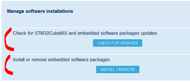

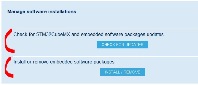

MHenz
October 28, 2021
Trying to install TouchGFX Generator 4.18 into CubeMX.
After clicking on "Refresh" . . . latest available version is 4.17.
4.18 is not listed.
Romain DIELEMAN
October 28, 2021
In STM32CubeMX make sure you first go to the "CHECK FOR UPDATES" window to look for and download the TouchGFX 4.18.0 package. Only then can you see it and install it from the "INSTALL/REMOVE" window.0693W00000FE1sCQAT.png
