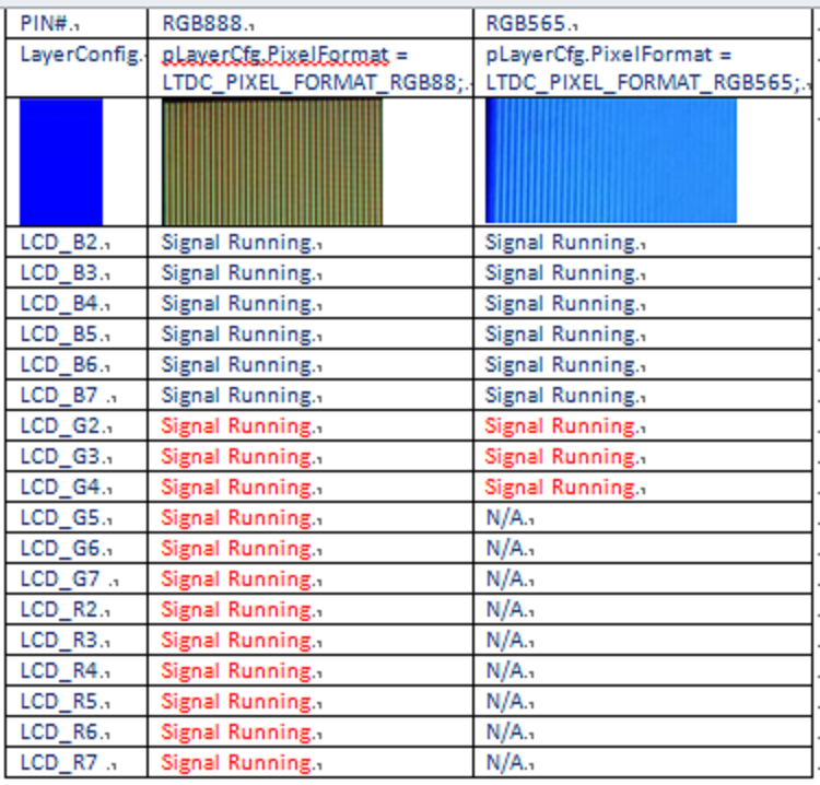

In my HW design, use LTDC R[2:7] , G[2:7] and B[2:7] for LCM.

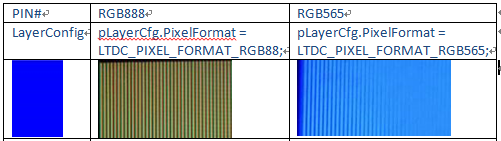

I generated a pure blue (B = 0xFF) picture as below table for ST boot screen.
pLayerCfg.FBStartAdress = (uint32_t *)image_data_sample_320_480_blue;
(See sample_320_480_blue.h)

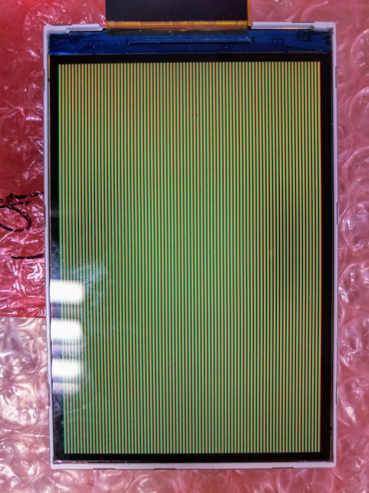

However, with above table, I saw RGB888 and RGB656 (just see different) both display not well.0690X000009YDakQAG.png

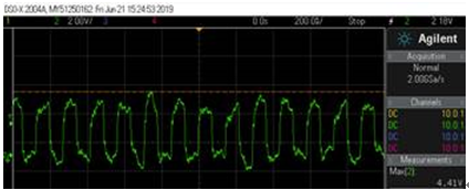

For further check on RGB888 case, I should only see signal running on LTDC B[2:7] pins
supposedly. But, after check each PINs (R[2:7] , G[2:7] and B[2:7]), I saw all RGB signal running on LTDC interface.
