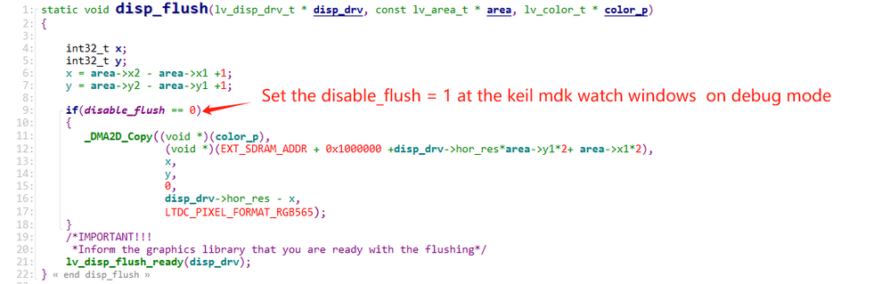

     Try to disable _DMA2D_Copy by set the global variable “disable_flush” to 1 in the route disp_flush in the lvgl disp port  file lv_port_disp_template.c  in order to stop any update on ltdc framebuffer.
        But I still see the issues.

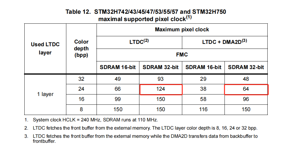

I recommend you to check the AN4861 and precisely section 4.2.2 Checking display compatibility considering the memory bandwidth requirements. This section explains how to check a display compatibility considering the framebuffer memory bandwidth. Also can help you to determinate pixel clock and LTDC required bandwidth.

       I have double checked the AN4861 and precisely section 4.2.2 Checking display compatibility considering the memory bandwidth requirements.
      20240315164949.png         Current the LCD Clk is 55Mhz, So, I think it is ok for  the memory bandwidth requirements.

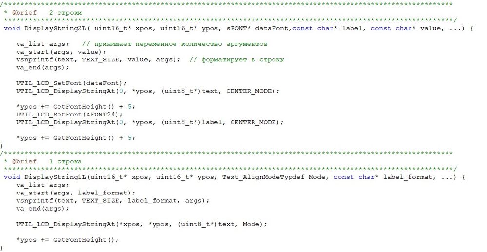

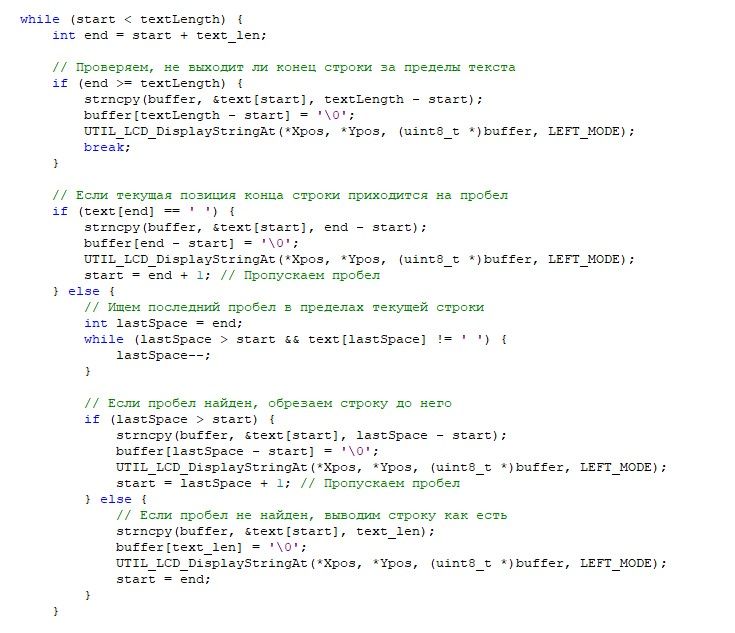

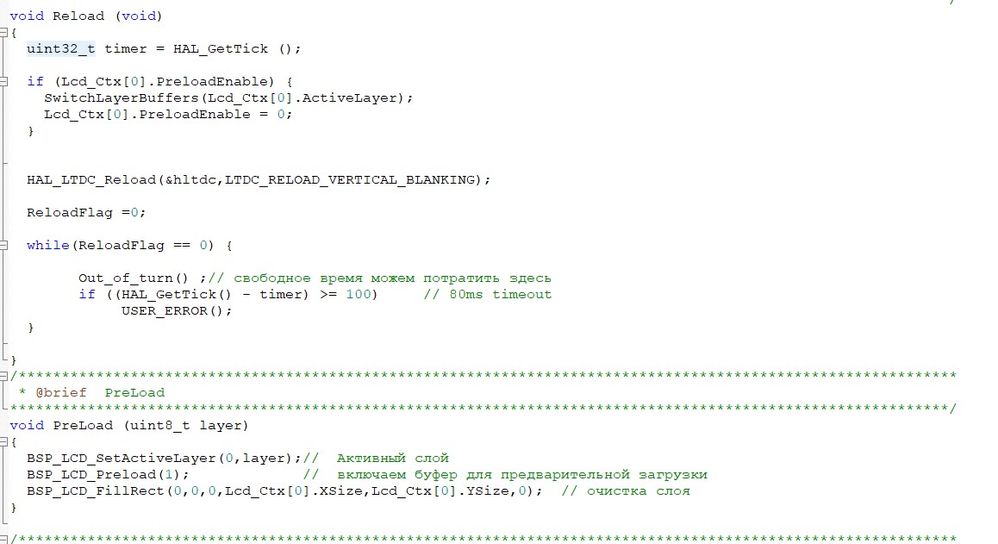

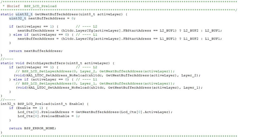

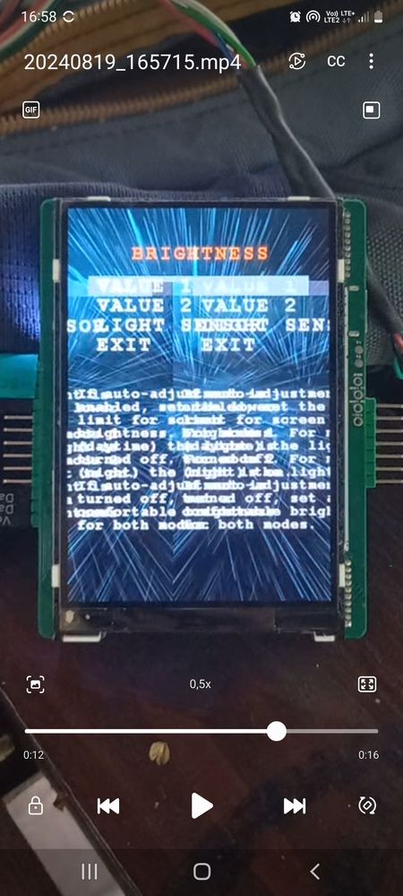

Hello, did you manage to solve the problem, I encountered a similar problem.
Please present YOUR problem, assume it's not the same, or the prior presentation was inadequate to solve on the forum.
I'd probably look to avoid situations where printf() is used, and potentially blocks, or is not thread-safe.
The problem occurs randomly very rarely, and I was not exactly able to determine the source. Error LTDC_FLAG_FU in this case a picture shift occurs. I'm using QSPI DUAL MODE + SDRAM 16bit + STM32H750. Screen 320 X 480 2 layers 32/32bpp 9.2 mhz. I tried to reduce the frequency to 5 mhz and even then the error appears.Screenshot_20240819-165847_Video Player.jpg
