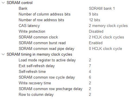

Hi, looks like it could be SDRAM configuration. Could you double check settings?
/Martin

I am using MT48LCM16A2TG SDRAM. Here is CubeMX timing values;
I checked values from datasheet. But i dont know why did happing.
So, if it is about sdram configuration, Why no problem occurs when i clear sdram?

Did you use MPU for ltdc buffer?
I've flickering issue when using ltdc, and it solve after i using MPU for ltdc buffer.
Or have you check the contact of lcd connection?
