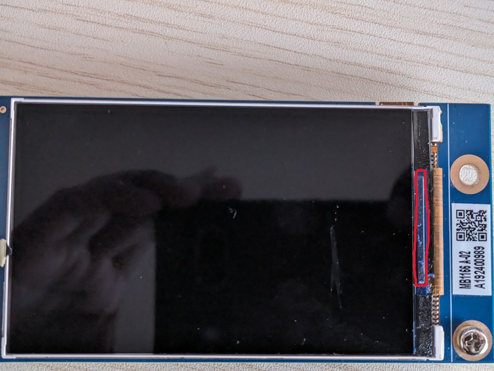

So i have tried to uploading one of the example project binaries and the display did not work . After a teardown i found this(highlighted in red boundary) whole region was hot (i could not keep my finger on there for long) but not burning.
Ordered a new display unit , hopefully i do not brick that too.
