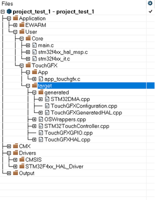

Actually, I created the project from CubeMX and added the TouchGFX as a software then generated the code files for IAR Workbench. It's kind of a requirement for my project to use the IAR Workbench. but when the project is created, I try to build it, but I get the error for some missing files. Like this...
Now I've checked my project directory and there is no folder named touchgfx/hal created here.
Following are the folders that were created...

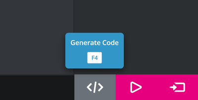

You did well on creating the project, but after that, you need to open the created TouchGFX project "ApplicationTemplate.touchgfx.part". Then, you need to generate code through TouchGFX (I added the picture for it), so, the required files are generated. Now, you can compile the IAR project.
Generate code in TouchGFX
Let me know about the progress
