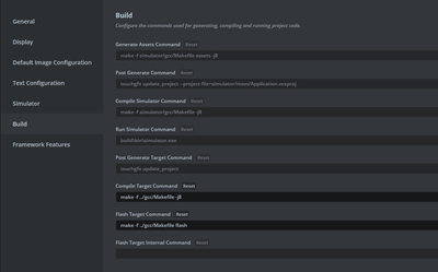

I use stm32H750ZBT6 to built a LCD driver , when i finished configuring with freeROS , toouchGFX , but STM32CUBE IDE have some error after compiling , touchGFX can't run into target , also,target icon is grey.
the error list photo as follows:
TouchGFX don't run into target and target icon is grey:

Hello @miker ,
1- To be able to run on target, you have to write your own Makefile, and configure your touchgfx project to exexute compilation target command :
You should try to get inspiration from our existing TBS to know what to put in your Makefile (in the gcc folder).
2- If you want to add an OS, we have an article explaining step by step how to do it. Please refer to this page
3- These logs are characteristic to wrong configuration of your linker file. You should try to check if the linker file of your STM32CubeIDE project is correct and you're placing your elements in the correct sections.
