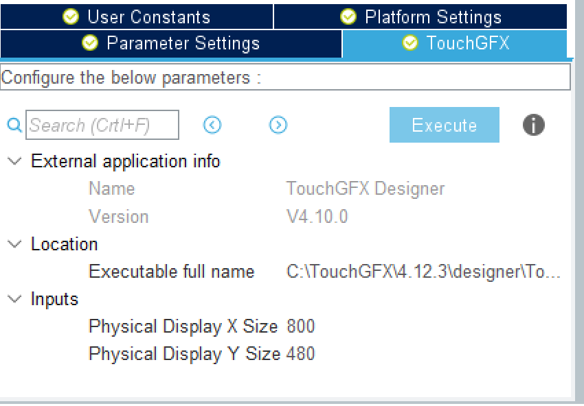

I have several errors while generating my code.
A few errors i am able to solve with excluding the simulator files from my project.
But now i have a new error with an undifened reference.
../TouchGFX/generated/fonts/src/GeneratedFont.cpp:12: undefined reference to `touchgfx::ConstFont::ConstFont
Do you have any workaround for me to solve this error?
EDIT:
I found in the CubeMX file the expected version 4.10 .
Maybe this could be a problem by generating the code?!

CubeMX does not generate TouchGFX code. We asked for the "External application info" description to be modified - It wants to tell you what the "minimum" required version is.
Did you remember to press "Generate code" in the designer?
/Martin

I saw that there is a new update for the IDE.
I will update my IDE now and take a look if it works with it.
Okay, I take it all back.
After the update everything works "without any problems".
You just have to make a few settings and the board works, just like before.
With the new IDE it is no longer necessary to manually remove the simulation files from the build process!
