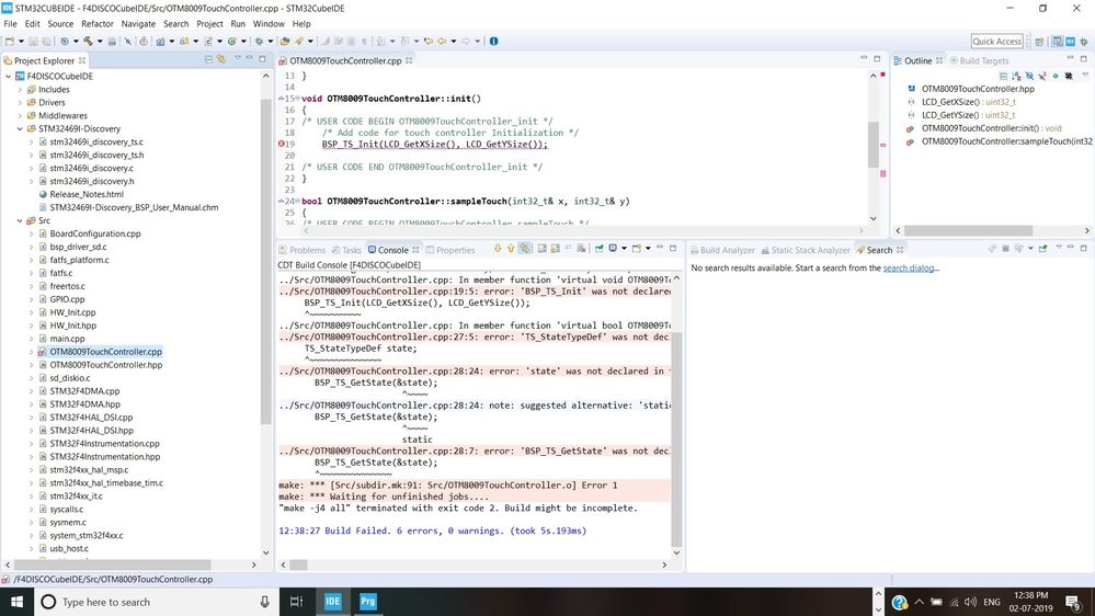

I got Error How can i resolve it
../Src/OTM8009TouchController.cpp: In member function 'virtual void OTM8009TouchController::init()':
../Src/OTM8009TouchController.cpp:19:5: error: 'BSP_TS_Init' was not declared in this scope
BSP_TS_Init(LCD_GetXSize(), LCD_GetYSize());
../Src/OTM8009TouchController.cpp: In member function 'virtual bool OTM8009TouchController::sampleTouch(int32_t&, int32_t&)':
../Src/OTM8009TouchController.cpp:27:5: error: 'TS_StateTypeDef' was not declared in this scope
TS_StateTypeDef state;
../Src/OTM8009TouchController.cpp:28:24: error: 'state' was not declared in this scope
BSP_TS_GetState(&state);
../Src/OTM8009TouchController.cpp:28:24: note: suggested alternative: 'static'
static
../Src/OTM8009TouchController.cpp:28:7: error: 'BSP_TS_GetState' was not declared in this scope
make: *** [Src/subdir.mk:91: Src/OTM8009TouchController.o] Error 1
make: *** Waiting for unfinished jobs....
"make -j4 all" terminated with exit code 2. Build might be incomplete.
11:30:54 Build Failed. 6 errors, 1 warnings. (took 4s.613ms)

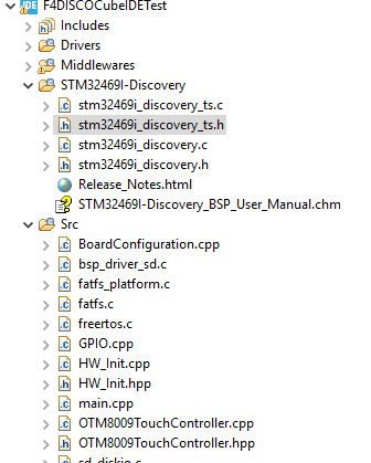

Couple of things to check first does your project contain the following source items.
Secondly I noticed your make command was 'make -j4 all' I'm using 'make -j12 all' also what version of make are you using?
‎2019-07-02 12:09 AM
I am Using
STM32CubeIDE
Version: 1.0.1
Build: 3139_20190612-1256 (UTC)
The Make is build in . How can i change that one.
My Files
