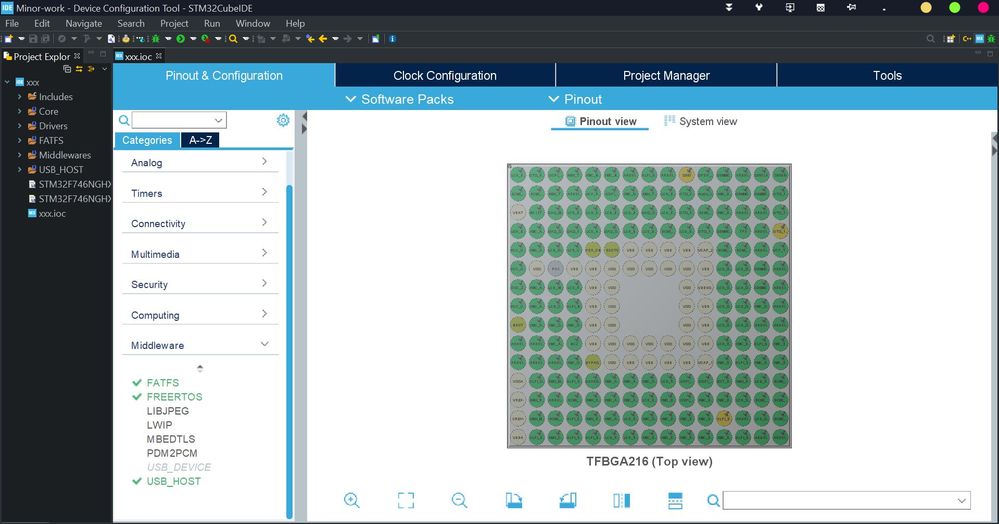

I am using STM32CUBE IDE v1.6.0 with TouchGFX v4.16.1 installed and using firmware version V1.16.0.
Yet in the Middleware sections, the graphics section is not there.

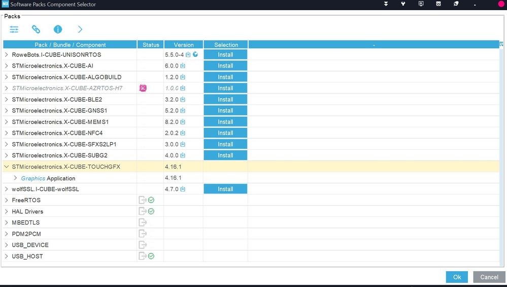

You skip one step, add pack to project and in new version you see it under midleware not in.
On your first image click on second line TouchGFX expand and add...
Thanks, this worked.
