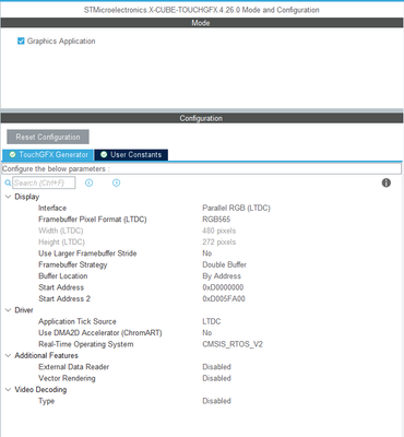

Hey, I am running into issues with a custom PCB based on STM32H743IIT6.

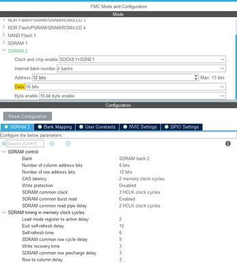

Using IS42S32400J-6TLI as SDRAM,  with an LCD screen. Using TouchGFX and DMA2D deactivated.

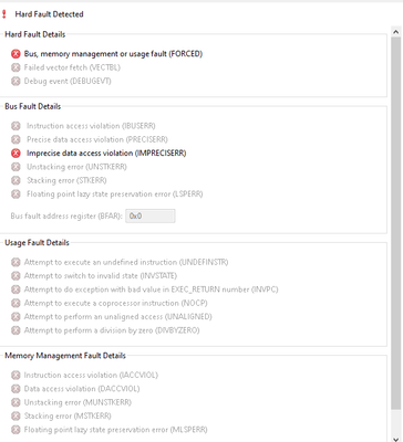

A hard fault is encountered after entering Model:Tick()
Hard Fault Error Detected at:
Debug stack view:

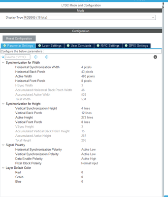

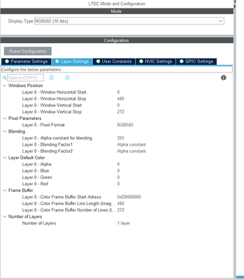

LTDC:
SDRAM - only 16 data bits used:
TouchGFX:

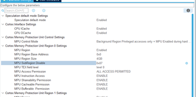

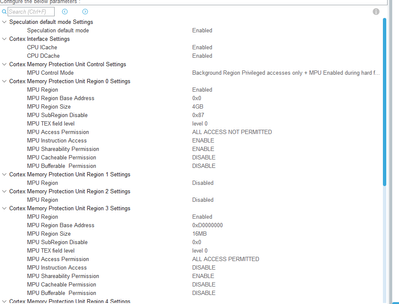

MCU:
Any suggestions what could be causing this Hard Fault error?
This was solved by setting the SDRAM, LTDC, and unlocking the MCU regions appropriately

Seems to go to
Then BusFault Handler at :
Applying new MCU settings:
I still get the BusFault_Handler error
