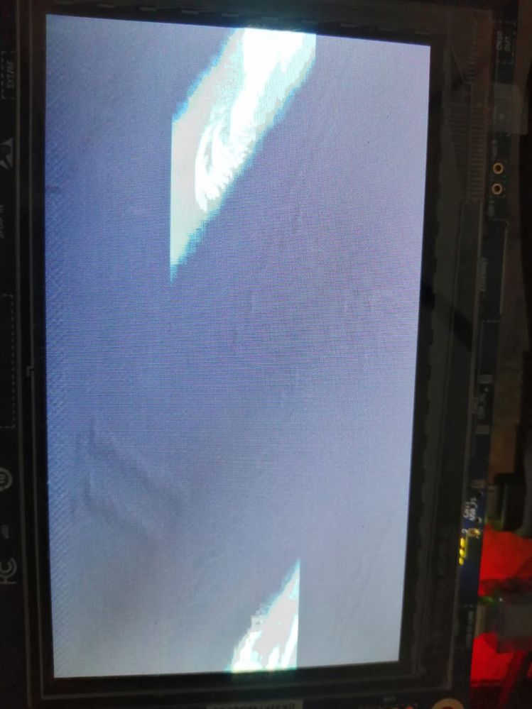

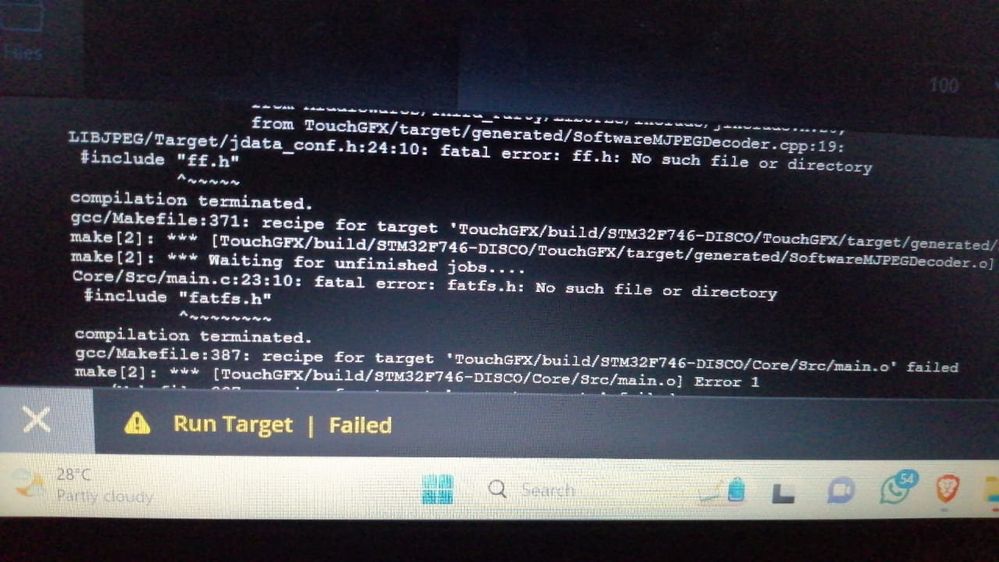

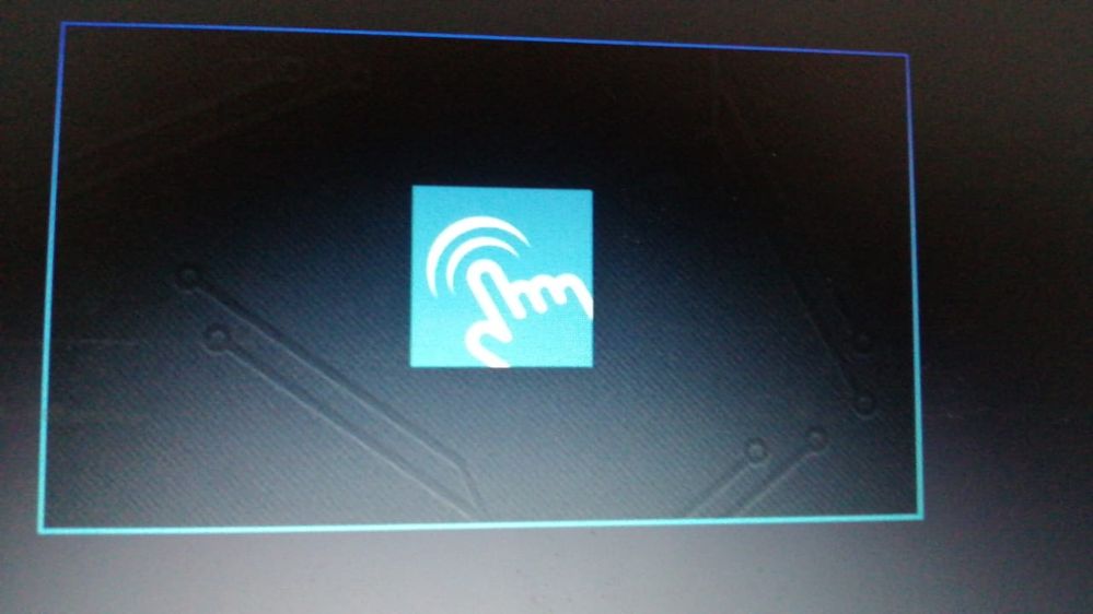

without even coding anything i just setup the SDMMC and FATFS and then with my working code that's for UI, I tried just uploading it. screen goes crazy when doing that, I not even code any thing just updated ioc and regenerated the code
sasmithadilshan
after sd card modeafter sd card modewhat it should bewhat it should becube ide build fine , but in toughgfx its not workingcube ide build fine , but in toughgfx its not working

Hello @sasmithadilshan ,
The makefiles from CubeIDE and Tgfx Designer are different, try to modify <YOUR_PROJECT>/gcc/MakeFile or put your files in  <YOUR_PROJECT>/TouchGFX/target.
Also refer to Using Non-Memory Mapped Flash for Storing Images | TouchGFX Documentation for reading image in a SD card.
Like @SofLit suggested, debugging may help you.
