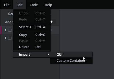

You can load the GUI only by clicking here:
Regards,
