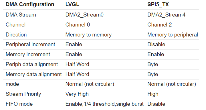

[DMA Configurations]
0693W00000FDqcDQAT.png[display driver using DMA2_Stream0]

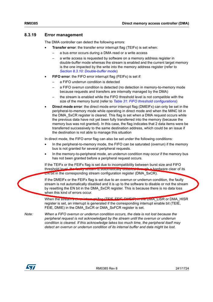

0693W00000GWOk6QAH.pngIn case of SPI Master Tx, there's no data loss as SPI simply stops the clocks if it does not have data to transmit. So it's safe to ignore DMA's FEIF.
As I've said above, SPI's OVF is an Rx error, because you didn't pick the first received frame before the second (and others) arrived. But you don't care about SPI's Rx anyway so it's safe to ignore it too.

Put the time-sensitive DMA request (SPI) at a higher priority than the memory to memory transfer.

As you said, it was a matter of priorities. When the priority of the SPI DMA request and the priority of the task executing SPI DMA were increased, no DMA error occurred. Thanks a lot.

While swapping priorities will change things, you can also safely ignore FIFO error in DMA stream which has FIFO switched off. SPI OVF is an Rx error, because you don't read out the Rx data, that's again safe to ignore if you only Tx on that SPI.

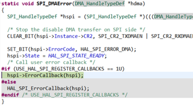

When a SPI DMA error occurred, it was not confirmed that other error flags were set other than the FEIF and OVR flags. Is there any other reason for the DMA error to occur? The problem is that once you enter the SPI DMA error routine, the HAL Library will turn DMA off.
