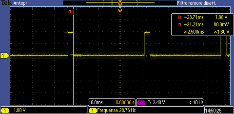

Hi @Martin KJELDSEN​ ,
at this link you can see what happens.
Also, this is the VSYNC signal captured
0690X00000AQoVBQA1.pngVSYNC the frequency is approx 29Hz
/Antonello

Great, since you can measure things check out GPIO.cpp. It may be empty for you, but you can Implement the methods there to toggle whatever pins you want to measure on. From TouchGFX, we toggle the following internally so you can measure performance metrics.
  typedef enum
    VSYNC_FREQ, /// Pin is toggled at each VSYNC
    RENDER_TIME, /// Pin is high when frame rendering begins, low when finished
    FRAME_RATE, /// Pin is toggled when the frame buffers are swapped.
    MCU_ACTIVE  /// Pin is high when the MCU is doing work (i.e. not in idle task).
  } GPIO_ID;
Your VSYNC seems slow. Can you tweak the pixel clock to speed it up?
/Martin

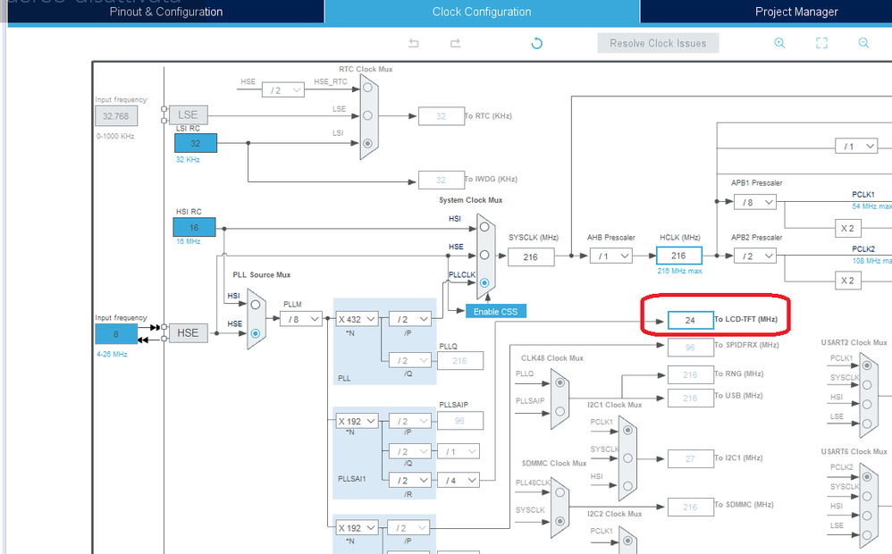

I had already modified the GPIO.cpp file for measurements.
The capture that I posted is related to the VSYNC_FREQ.
If I understand correctly, I can change the pixel clock via STM32Cube IDE Clock Configuration, as shown in the figure.
It's correct?
/Antonello

What i meant is that you can capture RENDER_TIME to find the time it takes to render an entire frame. You can use this to measure the time during transitions to get an idea.
Yes, you can change the clock like that, but through the derivative settings following the arrow (PLL).
/Martin
sorry for the delay in replying: I was trying to better understand VSYNC_FREQ, RENDER_TIME and FRAME_RATE from Measuring Performace Knowledge Base.
Anyway, I doubled pixel clock (from 24Mhz to 48Mhz) but "TopMenu" transaction does not seem to accelerate.
In the attached image, VSYNC_FREQ and RENDER_TIME when I "touch" to display slidemenu
/Anonello
