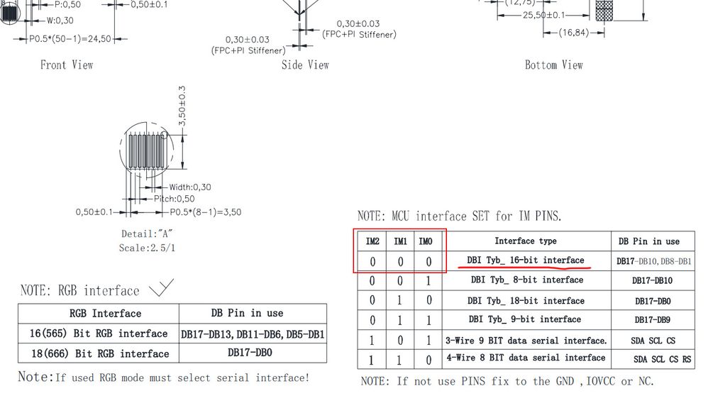

Interesting, let's see that display/hardware. You probably just forgot to set the TFT's interface to 16bits and the thing pulls it down, dunno. For example: one I'm using here requires IM0/1/2 inputs to be LOW for 16-bits. You have the pinout of your display and it's interfacing modes (datasheet) so we can have a look?

I'm having the same IM0-IM2 settings as your screen. I'm connecting all 3 ports to GND. Also I'm connecting DB9 and DB0 to GND as well as all other not used pins (such as SPI-pins for example.
I'm wiring DB17:DB10(LCD) to DB15:DB8(STM32) and DB8:DB1(LCD) to DB7:DB1(STM32). That should be correct I think.
