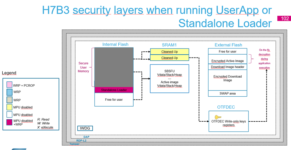

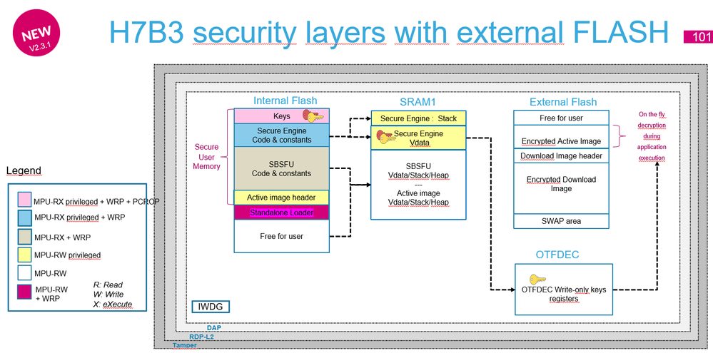

Fred
be careful that the idea is also that the slots stored in external FLASH are encrypted:
Fred
Which gives when running your application:
sute
Thanks for the reply. This is interesting and I think I may have misunderstood something then, as I remember reading that the external flash is not encrypted (can't remember where though). If this is the case then what if I have one active slot in the internal flash for which there is a corresponding download slot in the external flash. Is the data in the external flash always encrypted?
I think one of the diagrams is wrong as it indicates a non-encrypted firmware image.
This was not the design principle but I need to check the implementation.
I would trust the Figure 63.
Ok, it is encrypted:
