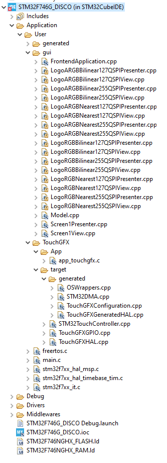

‎2020-01-21 2:25 PM
I tried regenerating code from within TouchGFX Designer, same error. From within STM32CubeIDE I also tried right clicking on the project and clicking "refresh", that didn't help.
The file "LogoARGBBilenear127QSPIPresenter.cpp" does not exist in my project. I just let STM32CubeIDE import the project. I didn't do anything special after that such as import other files, I figured STM32CubeIDE would know which files to import. I have attached a screen shot of the structure of the freshly imported project. To me, it does seem incomplete.
EDIT: It looks like the files might want to be in the project, but they have this yellow exclamation mark next to them. Check the new screen shot
‎2020-01-21 2:29 PM
This looks really weird!
You have .o files listed, among other things. And no code files. Very strange. Send me the project.

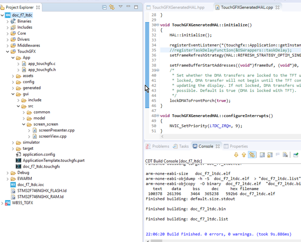

‎2020-01-21 2:32 PM
I see you updated the post - Can you open those code files? Here's a CubeIDE project i just generated
‎2020-01-21 2:34 PM
I cannot open those files, screen shot attached...
