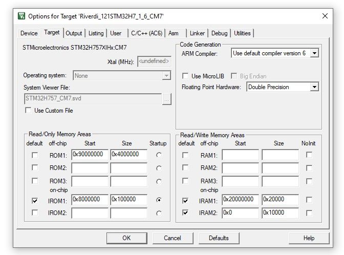

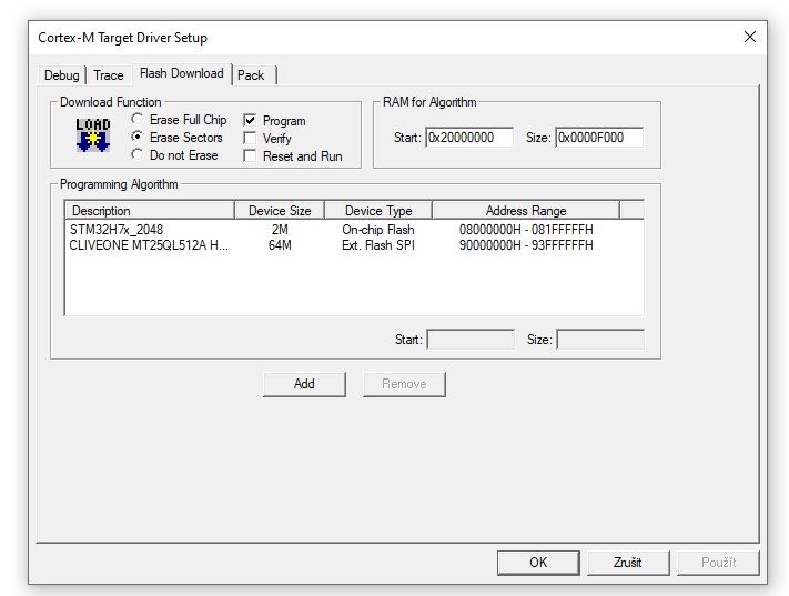

Hi
Thanks for the info.
LR_IROM1 0x08000000 0x00100000  {    ; load region for FLASH (1MB)
  ER_IROM1 0x08000000 0x00100000  {  ; execution region for FLASH
    *.o (RESET, +First)           ; Vector table
    *(InRoot$$Sections)
    .ANY (+RO)
    .ANY (+XO)
    .ANY (.text*)
    .ANY (.rodata*)
    .ANY (.ARM.extab*)
    .ANY (.ARM.exidx*)
    .ANY (.init_array*)
    .ANY (.fini_array*)
    .ANY (.preinit_array*)
LR_RAM_D1 0x24000000 0x00080000  {  ; RAM_D1 (512K)
  ER_RAM_D1 0x24000000 0x00080000  {
    .ANY (+RW +ZI)
    .ANY (.data*)
    .ANY (.bss*)
    .ANY (.RamFunc*)
    .ANY (.RamFunc*)
    .ANY (.bss)
    .ANY (COMMON)
    .ANY (._user_heap_stack)
LR_RAM_D2 0x30000000 0x00048000  {  ; RAM_D2 (288K)
  ER_RAM_D2 0x30000000 0x00048000  {
    .ANY (.RxDecripSection)
    .ANY (.TxDecripSection)
    .ANY (.Rx_PoolSection)
LR_QUADSPI 0x90000000 0x04000000  { ; QUADSPI (64MB)
  ER_QUADSPI 0x90000000 0x04000000  {
    .ANY (ExtFlashSection)
    .ANY (ExtFlashSection.*)
    .ANY (.gnu.linkonce.r.*)
LR_SDRAM 0xD0000000 0x005DC000  {   ; SDRAM (6000K)
  ER_SDRAM 0xD0000000 0x005DC000  {
    .ANY (TouchGFX_Framebuffer)
    .ANY (TouchGFX_Framebuffer.*)
LR_SDRAM2 0xD05DC000 0x00224000  {  ; SDRAM2 (2192K)
  ER_SDRAM2 0xD05DC000 0x00224000  {
    .ANY (Video_RGB_Buffer)
    .ANY (Video_RGB_Buffer.*)

The code generated by CUBEMX and TouchGfx for MDK ARM cannot be compiled.
The generated code contains many errors and the compiler cannot compile or link it.
There is also a problem with programming (debugging)
A functional external loader is missing.
The Riverdi board uses an external QSPI flash.
There are many problems
so the conclusion is .. not yet usable for MDK-ARM
I tried to implement all the information from
https://support.touchgfx.com/docs/development/scenarios/converting-keil5-project-to-keil6
and from
https://community.st.com/t5/stm32-mcus-touchgfx-and-gui/when-using-arm-v6-compiler-the-touchgfx-program-cannot-run/td-p/846333
I uploaded the HEX compiled with MDK using cubeprogrammer and an external loader.
The program probably doesn't run. The screen is black.
It would be necessary to create an external FLM loader for the riverdi board.

Hi
I found a way to get the external loader working.
I had to edit the scatter file.
I'll do some more tests and write a report
