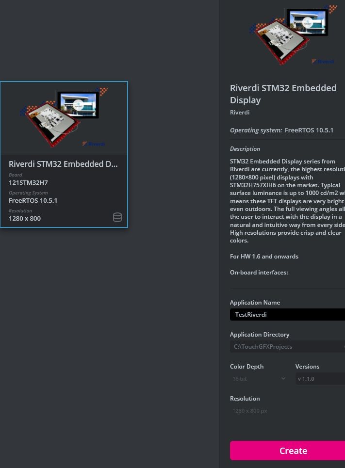

Hello I have a problem compiling TouchGFX for Keil. My procedure:
1/ Run TouchGFX Designer 4.25
2/ Create New project
3/ Go to tab – By Partners – select board Riverdi STM32 121STM32H7
4/ Click to Create
5/ Add Button ( for example)

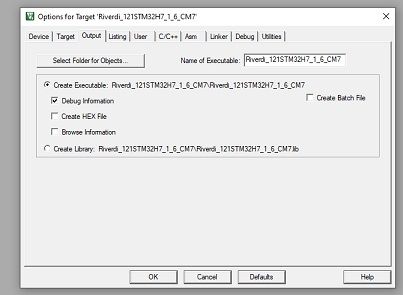

13/ Go to Option for target Go to tab OUTPUT
and uncheck Browse information

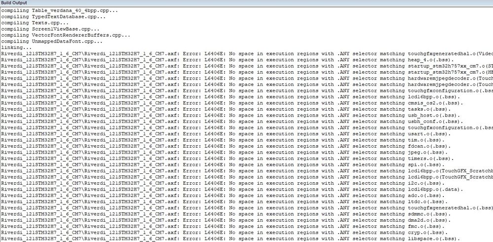

14/ Project build target
15 / Keil linking problem Not enough information to list image symbols.
Not enough information to list load addresses in the image map.
Finished: 2 information, 0 warning and 81 error messages.
"Riverdi_121STM32H7_1_6_CM7\Riverdi_121STM32H7_1_6_CM7.axf" - 81 Error(s), 0 Warning(s).
Target not created.
Build Time Elapsed: 00:00:14
Can anyone please solve the problem with compiling this Riverdi display for KEIL? Please try to compile a simple project for Riverdi STM32H7 display in MDK KEIL.

Hi OSMAN I tried your SCATTER file.
The compiler reports this error
linking...
Riverdi_121STM32H7_1_6_CM7\Riverdi_121STM32H7_1_6_CM7.axf: Error: L6218E: Undefined symbol ExitRun0Mode (referred from startup_stm32h757xx_cm7.o).
Finished: 2 information, 0 warning and 1 error messages.
"Riverdi_121STM32H7_1_6_CM7\Riverdi_121STM32H7_1_6_CM7.axf" - 1 Error(s), 0 Warning(s).
Target not created.
another attempt with the V6 compiler

    #endif /* USE_PWR_LDO_SUPPLY */
  • 2nd suggestion: IF 1st suggestion didn't work try to remove these 3 lines from startup_stm32h757xx_cm7.s and startup_stm32h757xx_cm4.s files (under Application/MDK-ARM)
  • 3rd suggestion: If 1st and 2nd suggestion didn't work try to use an older version of TouchGFX Designer (it has to be before 4.25.0)
Osman SOYKURT
Hi Osman. Thank you very much for your help. Currently the compiler compiles the project without any problems.
