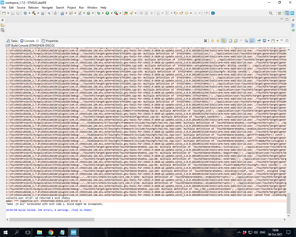

0693W00000FBg6XQAT.pngHi Imen. I managed to get rid of the simulator files but I am getting compiler errors such as the ones above. I followed the prompts from another ST Microelectronics video (https://youtu.be/VOs2LYO7wSA) but the solution shown has not solved the problem. Any aassistance regarding this matter will be apppreciated.

would be better to copy & paste the text - your image has truncated the messages.
Fortunately, when you get loads of messages like that it's often down to just one problem (or a few problems) - fix them, and all the messages will go away.
The key is to address the earliest-reported message first.

The text (manually truncated ) is shown below, it extends for 500-odd lines in my console:
c:\st\stm32cubeide_1.6.1\stm32cubeide\plugins\com.st.stm32cube.ide.mcu.externaltools.gnu-tools-for-stm32.9-2020-q2-update.win32_2.0.0.202105311346\tools\arm-none-eabi\bin\ld.exe: ./Core/Src/main.o: in function `StartDefaultTask':
C:/ST/System/System/STM32CubeIDE/Debug/../Core/Src/main.c:1086: multiple definition of `StartDefaultTask'; ./Application/User/main.o:C:/ST/System/System/Core/Src/main.c:1086: first defined here

You have multiple source files redefining functions. Having two main.c files within a project should not happen.
