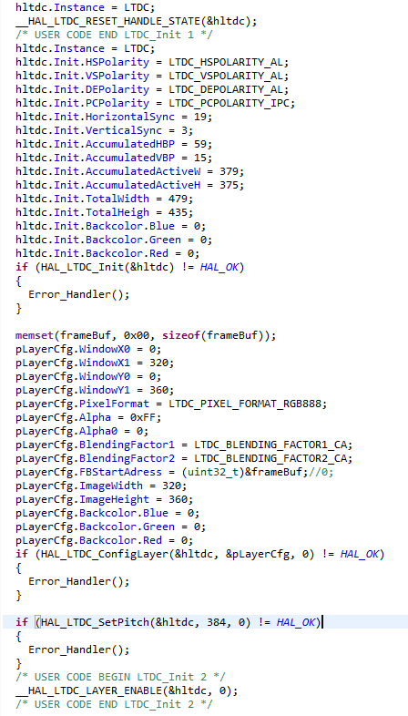

1. First, I started to do porting the DSI display(24bit color), by just setting a framebuffer connected to a buffer in internal SRAM(global array). It was finally succeeded as below, the content is RGB pattern what I generated by couple of for loops to fill the framebuffers.

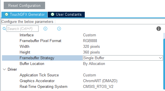

- setup TouchGFX configuration in ioc file of STM32CubeIDE tool

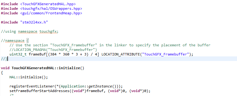

- declared framebuffer as buffer allocation and set it also as LTDC framebuffer, by externing the array in main.c file
But what I see in this case is, something wrong.
- My display doesn't show the buffer correctly.
- It seems like it is something stretched than it's original size.
- It seems like one black(or empty) line is inserted every line after one red line.
Is there anyone who has this kind of experience before?
I don't really know where to start my debugging in this kind of situation.

<TouchGFX configuration in ioc file>

<TouchGFXGeneratedHAL.cpp file - for buffer declaration point>

I see primary trouble , that you set Custom drivers. When you use DSI with full framebuffer, you need set LTDC not Custom.

I will try to change the Display Interface from Custom to Parallel RGB(LTDC) as you suggested, and let you know about the result.

I tried your suggestion, but there was no change.
It seems it makes changes on TouchGFXGeneratedHAL.cpp side, such as lcd_int_active_line/lcd_int_porch_line and new callback as 'HAL_LTDC_LineEventCallback'. But it seems this callback is never called. Do we need to setup additional configuration to make this callback work?

I finally needed two changes to correctly display my TouchGFX resources.
- Set Display Interface from Custom to Parallel RGB(LTDC) as MM..1 mentioned.(Thanks again MM..1 for mentioning it ! )
- Set Correct Framebuffer Width in TouchGFXHAL.cpp file.
As I was using the original version from ​STM32L4R9I EVAL board, it was defined based on GFXMMU dependent buffer width(3072/2).
The definition goes like BSP_LCD_IMAGE_WIDTH -> GUI_FRAME_BUFFER_WIDTH -> FRAME_BUFFER_WIDTH, finally.
After correcting the width as the one considering DMA2D transfer width, I can see outputs from TouchGFX delivered by DMA2D finally.
