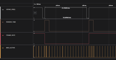

Are you using the TBS available in TouchGFX Designer? If so, connect a logic analyzer and measure the VSYNC frequency. This should be approximately 16.67 ms, as shown in the measurement below.
You can find the signals on the spare GPIO connector (CN1) located on the left side of the DK board. The mapping is also mentioned in the readme file of the TBS. VSYNC_FREQ is mapped to PC0 (CN1 pin 14).

Thank you Johan for the information.  I have implemented exactly the same, but I was not sure it is the right way or most simplest and correct way.  Everything has to go thru MPV model.
One thing I found I lost is you are using %60 for the 1 second but my tick somehow way faster.  Is it my STM32U5G9-DK2 has different clock setup so the Model::tick() will be call in 60?
