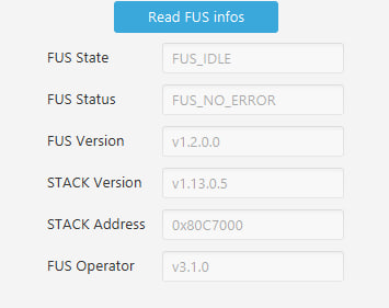

Just a quick update and a follow-up question. A huge thanks to you, your hint was spot on. As always, you're the best on this!
I managed to get the BLE running on one of my boards. I flashed it with stm32wb5x_BLE_Stack_full_fw.bin v1.13.0.5, and it worked. The newer v1.22 and v1.23 stacks wouldn't flash.
My question is, should I be worried about using this older stack? It would probably be good to have a newer version, right?
Do I have to update my FUS to use them? If I understood correctly, there's a warning about FUS v2.0 forcing updates over USB. What's the latest version I can safely upgrade to and still be able to flash everything with my J-Link?
Thanks for any advice!

I apologize for late reply, I'm glad it works now.
Regarding the stack version, for getting new v1.22 and higher, the FUS needs to be updated.
Please update STM32CubeProgrammer to the latest version as it removes the previous limitation.
For more information, please open this folder with releases notes.
STM32Cube/Repository/STM32Cube_FW_WB_V1.23.0/Projects/STM32WB_Copro_Wireless_Binaries/STM32WB5x/Release_Notes.html
For more information about FUS.
STM32WB Firmware Upgrade Service - stm32mcu
