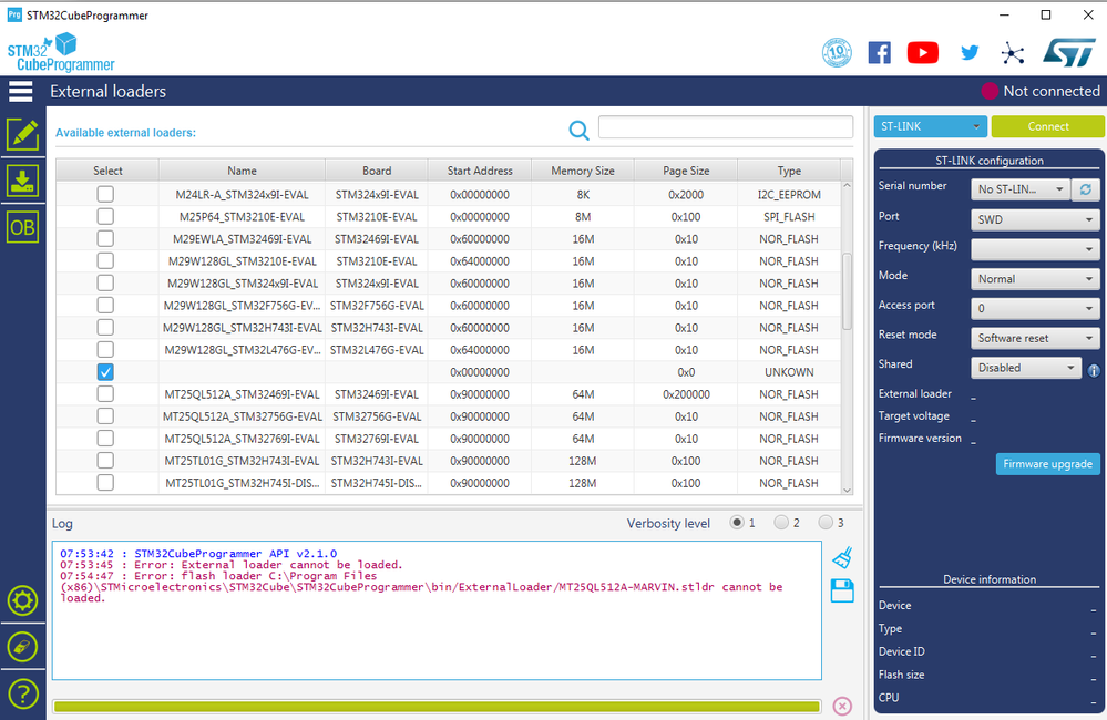

I am trying my best to get it working.
Have you already build an external loader with atollic?
I'm trying to get the N25Q512A_STM32F769I-EVAL from the ST-LINK Utility/ExternalLoader folder working. I've copied the folder to STM32Cube_FW_F7_Vx.y.z\Projects\STM32F769I-EVAL\Examples\QSPI as described in the readme file.
When I open the .project file it said that it couldn't import all settings and I may have to do some changes manually.
This is what my project looks alike. I added the folder Loader and linked the .c files to it.
The good thing is that it builds. The next step was to rename the .elf to .stldr and copy it to the CubeProgrammer folder.
When starting the CubeProgrammer it says "Error: flash loader C:\Program Files (x86)\STMicroelectronics\STM32Cube\STM32CubeProgrammer\bin/ExternalLoader/MT25QL512A-MARVIN.stldr cannot be loaded."
‎2019-08-13 7:25 AM
I'm not using Atollic, I'm a Keil guy, and when I do GNU/GCC stuff I use makefiles.
Earlier versions of Cube STM32 Programmer seemed to enumerate the directory for *.stldr files, but then use the internal naming as the file naming when attempting to load them. The .ELF loader also has somewhat constrained expectations about the type/structure of file it would load properly.
