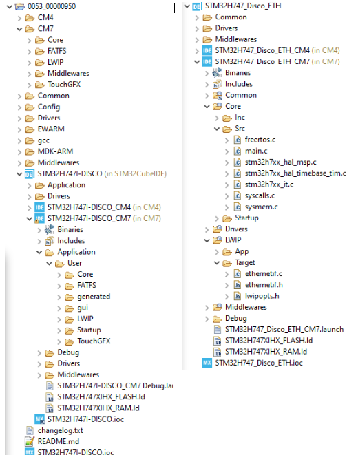

i am having problems with TouchGFX generated Project and LWIP/Ethernet
My Software setup:
STMCubeIDE Version: 1.9.0
TouchGFX Version: 4.19.1
STM32Cube_FW_H7_V1.10.0
My Hardware setup:
STM32H747I-DISCO
I have followed the steps in the ST-article How-to-create-project-for-STM32H7-with-Ethernet-and-LwIP-stack-working (can't add link) but can't ping the board. There is no Ethernet interrupt or RX callback, but GPIOs are set to high speed and ETH global interrupt is enabled and set to priorty 5 - preemption and 0 - subpriority.
Ping works in the attached example from the article, even when I migrate to the new H7-FW (after using the steps under 10. STM32Cube_FW_H7_V1.10.0 (and newer) specific issues).
I think there might be a problem with the MPU region, since I read somewhere that the M4 core is accessing the 0x30040000 with 0x10040000 and I have setup the same address there (sorry i am new to dualcore and mpu configs - see region 4 to 7 in my config). here is my config:

Another clue I got is this: in the ethernetif.h there is this complete section grayes out, but i am using the GNU Compiler:
#if defined ( __ICCARM__ ) /*!< IAR Compiler */
#pragma location = 0x30000260
extern u8_t memp_memory_RX_POOL_base[];
#elif defined ( __CC_ARM ) /* MDK ARM Compiler */
__attribute__((at(0x30000260)) extern u8_t memp_memory_RX_POOL_base[];
#elif defined ( __GNUC__ ) /* GNU Compiler */
__attribute__((section(".Rx_PoolSection"))) extern u8_t memp_memory_RX_POOL_base[];
#endif
So I think the problem could be the structure of the TouchGFX generated Project.
On the left is the TouchGFX generated Project, which links only some files to the CM7 Subproject and on the right is the example project which has the files directly included in the CM7 subproject
Thank you for any help and hints!

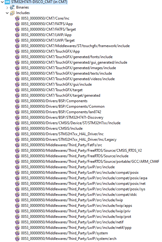

Hello ! I'm facing the same kind of problem.
I generated a project with TouchGFX Designer, opened the .ioc file with CubeMX and added Ethernet connectivity along with the LwIP stack.
I opened the project with CubeIDE and it seems that it cannot build the project because there are no reference to "lwip.h" (eventhough I can open it by right-clicking it -> open declaration). Just like you said, the LwIP files are in the first CM7 folder. I tried including paths in the settings of the project for eliminating some of the undefined references but it wasn't the solution. What did you do exactly for changing the structure of your project and linking the files ?
I didn't change the structure of my project. I just open the Project with "open Projects from File System", add my files to CM7/Core/Inc and /Src and generate a file link of my files in /Src to STM32CubeIDE\CM7\Application\User\Core. I didn't have problems with the link files, CubeIDE just can't see the code in your Project, when you open files outside of it (especially included files).
Here is a screenshot of my includes for comparison:
