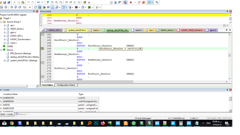

I successfully used a HAL code I found on Github for driving an ili9341 TFT LCD with SPI then I rewrote the code with registers. Part of my code works and I am able to fill pixels with color but when I try to use a function named ILI9341_Draw_Colour_Burst the code doesn't work. I tried to use the Keil debugger to see what happens and it showed a hard fault occurred. The function code is shown below

my problem is solved! I changed the BURST_MAX_SIZE value from 500 to 100 and the function worked! I'm still curious that what was the reason behind the hard fault
i attached an image of the hard fault error of the debugger.

What do the SCB fault registers say when the hardfault occurs ?
Can you switch to instruction step mode, and step to the critical sections ?
Register values will usually quickly reveal the problem.
