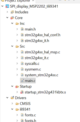

What errors hapened?:
  • First I got an error, that the assembly file "startup_stm32g431kbtx.s" in the folder /Core/Startup/ cannot find "main" at the line 195 "bl main" at the block "LoopFillzerobss"
  • I sadly forgot the measure I took to solve that problem, I guess it was adding the include path for the main.c and main.h at any point
  • Since then I got a new error message, following...

I forgot to mention, that the main.c is lined weirdly, like it has no permission or something.

I found the issue.
I cannot help, but because of anything the code part of the assembly file I mentioned until
FillZerobss:
str r3, [r2]
adds r2, r2, #4
was indeed copied and pasted after the first one, so the symbols was double existent. And that is not all, there was more parts nonsenseful copied. Very weird.
So I decided to create a new project with the settings and code changes I mentioned.
