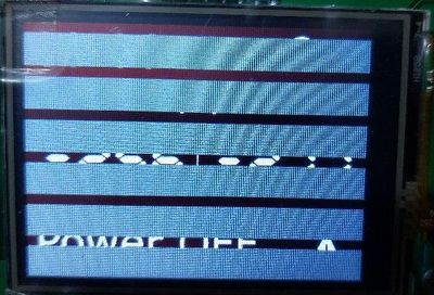

I tryed to follow the G071 example code. The LCD is up and working and i'm able to fill it with color before the GUI starts. But after that i'm facing this on my display and can't figure out where is the problem.
It's looks like the framework doesn't sending the whole blocks and after a few lines it's stops till next transmition.

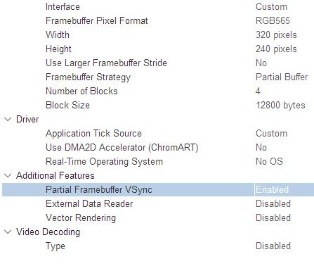

January 17, 2025
Hello @GaetanGodart and thanks for your attention,
Can you try without the TE pin implementation?
 For this i disabled the parameter in CubeMX
then in systick timer
if (frame_tick_ms++ > 80) {
 frame_tick_ms = 0;
 touchgfxSignalVSync();
 I'm getting same result.

Ok my bad. You actually stay in low state for 5 ticks and in high state for 85 ticks. What is the duration for the timer  that you use?
In your video, we see artefacts of the upper half on the bottom half. The video last 4 seconds and we see the artefacts 6 times in total. The artefacts shows at repeated timings.
If your tick timer is meant to be "shot" 120 times per seconds, since you have a 90 ticks cycle, the artefact and the rising/falling edge would be in phase so we would be almost sure that it happens every time you refresh your screen.
In that case, you refresh your screen quite rarely (around 1,3 frames per second).
