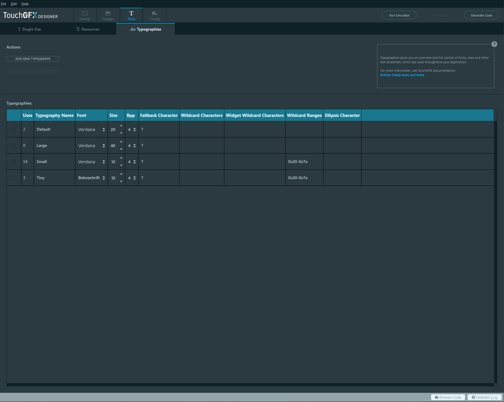

I recommend adding the entire ASCII character set to your wildcard range for the font that you are using. This will allow you to leave your TextArea blank.
In your Wildcard Ranges field enter the values: 0x20-0x7e

i was trying by writting A-F in wildcard character under typoghrapies under texts in touchgfx but if i write "AvgdbdvZ" in my buffer...
it is displaying "A??????F" it is treating it as A and - and F but it should take all characters ...what is the issue in this case

2020-02-06 6:53 AM
sry:) dear JHard it is working fine now...issue fixed
thank you very much....
