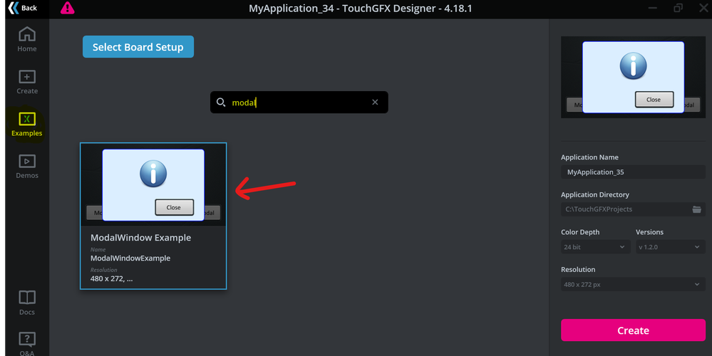

By the way, just remembered, we actually have a example in TouchGFX Designer about popup, it's called "ModalWindow Example".
0693W00000KZaNRQA1.png/Osman
