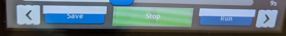

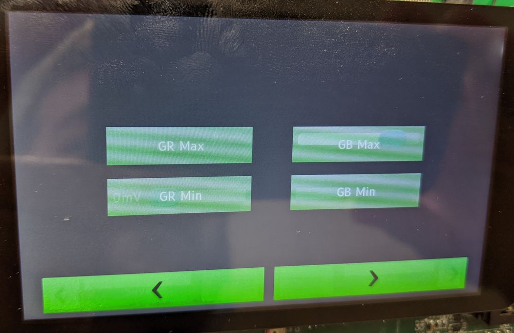

I've come across some odd behaviour and wanted to check in with you on it.
I have been developing a project since TouchGFX 4.14 I believe, that I've been running and migrating through the updates without much hassle.
Today, I migrated to 4.17.0, and copied/ pasted a Text Area from one screen to another (I know, my bad !).
This is ultimately the change I found altered the project: I run into Hardfault Handler every time the TouchGFX task starts.
Removing that bit of Text Area "solves" the problem, aka my board boots up, but I end up with either errated colors on my images, or overlapping adjacent screens on/ through my buttons (see pictures). Also the rest of my program does NOT run fine (no comms, no I/O, nothing seems alive - I have yet to determine what is and isn't).

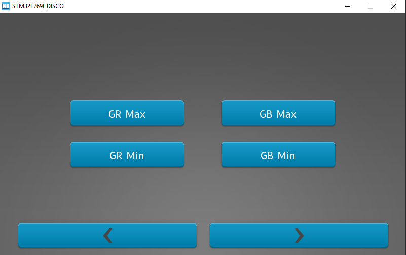

0693W00000FAhx7QAD.jpg0693W00000FAhyxQAD.jpgFor reference (in simulator, which runs fine in any case):
0693W00000FAi0jQAD.png0693W00000FAi0UQAT.pngWhat could possibly have gone wrong during the migration ?
My project runs on a STM32F769II-DISC0 board. If you need more info I can provide, but not the project files as it is confidential.

Hello JMS,
So your problem occured when you migrated from 4.16.1 to 4.17 ?
When migrating a project from one version to the other, you should also migrate the TouchGFX Generator to the same version in CubeMX.
Copy/pasting a TextArea does not seem like a big issue that could ruin your project in my opinion.
When you debug, is it running correctly ?
Artifacts can come from different sources such as the display initialization, the Flash communication, wrong TouchGFX synchronization, etc.
I suggest you compare with the project version that was working to see any discrepancy that seems odd.
/Alexandre

Yes, it occured when migrating from 4.16.0 to 4.17. I did what you told me, migrating everything to the most up-to-date version (CubeMX as well as the TouchGFX Generator, and also CubeIDE just to be sure).
When I debug, it runs correctly now (for some reason) - I have my UARTs, my , albeit one of my screens (the screen where I pasted the TextArea in question) freezes the GUI (while not stopping the other tasks). I haven't figured where the GUI task stops yet.

Hello JMS,
Did you try to see if it works on the simulator ? Removing hardware related code like UART.
/Alexandre
Hello, it was running fine in the simulator when I initially posted (you can see the screenshots in my original post).
