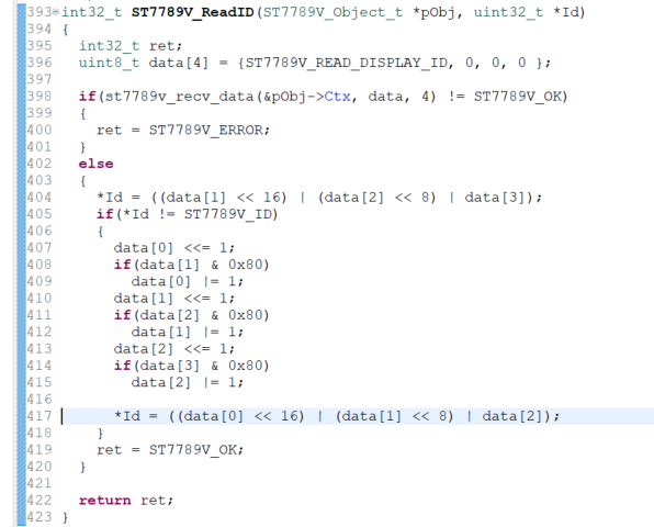

I'm running the following git source on the NUCLEO-G071RB with NUCLEO-GFX01M2.
GitHub - lvgl/lv_port_stm_nucleo_g071rb: LVGL ported to ST's NUCLEO G071RB board
But, I got an error at the cursor location from the attached figure (LCD Error 1.png).
The return value of "data" from st7789v_recv_data function was all 0.
I'm not sure this is correct. I guess there should be some values in it.
When I run the X-Cube-Display sample program, I got the same error.
Please let me know what cause this kind of error.

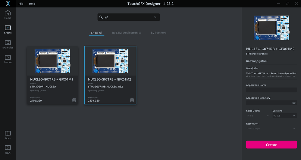

Hello @jasonlee3 ,
I'm not sure if you are planning on using graphics on your board or not, but I suggest using TouchGFX instead of your current project.
TouchGFX has already a Board Setup which contains all the required settings for NUCLEO-G071RB + GFX01M2; You just need to develop your GUI and the rest in handled by TouchGFX.
TouchGFX Board Setup for NUCLEO-G071RB
I hope this helps you, don't hesitate to ask more questions
