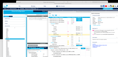

I am new at the STM32 World.
I started to buy a nucleo-f767zi and it worked fine.
I was not able to get the debug Console running. Like other too.
Because of that I bought the extension Board  x-nucleo-GFX02zi which should be working fine with the F767ZI.
Now I tried with CubeMX to installed the Hello World Example provided.
But now I get the Message that these Packets is not Support with CubeMX 6.11. It should be support by Version 6.7 until 6.8.2.
I tested 6.8.2 and 6.8 but without any changes. It seams like the SPI does not fit together. Always I got no solution found.
Does the GFX02zi can be used with the F767ZI? Or do I have to everything new.

Hello @Carsten73 and welcome to the community!
So you are trying to use the "Hello World" example from STM32CubeMx?
I am not a STM32CubeMx expert, it seems like using an older version of STM32CubeMx should have solved your problem but it did not :| .
I recommend you to create a new thread clearly stating your issue related to STM32CubeMx on the sub forum specific to STM32CubeMx : stm32cubemx-forum
Yes, the STM32F767 nucleo board is compatible with the GFX02z1, see this link : x-nucleo-gfx02z1

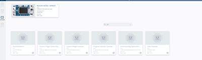

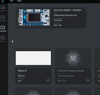

Hi Gaetan,
I followed your guidance to use Touchgfx instead and use the starting Point of a existing Example for the LCD Board with STM32U575.
See the image attached. If i go in detail, no example is available. The resolution does not fit and I am not able to choose one to move forward.
Thanks
Carsten
Hello @Carsten73 ,
Yes, we don't have examples for 240*320 pixels screen.
You should be able to create a blank UI :
From there you can add elements in Designer.
If you really want to see how examples work, you can just select them without selecting a board but instead selecting the simulator.
Regards,
Gaetan Godart
Software engineer at ST (TouchGFX)
