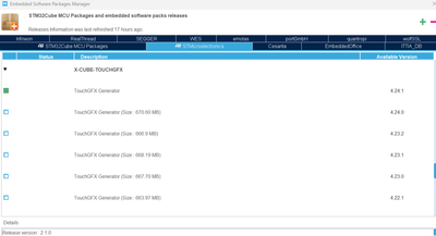

Show your image list TouchGFX versions , as you see on my 4.24.1 is marked red = not usable with IDE and MX version. But 4.23.2 isnt marked then checkbox it and install. After installed ...

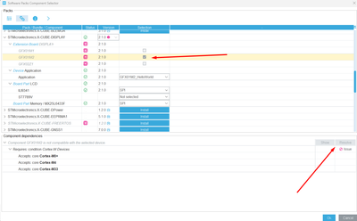

I don't have any marked red:

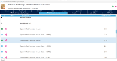

this is my x-cube-display:
I've managed to get it set up in the MCU by clicking the resolve button shown by the red arrow. When clicked, it checked the display, the part that I cannot toggle.
I wanted to do the "Hello World" application or something to try it out, but nothing changed physically.

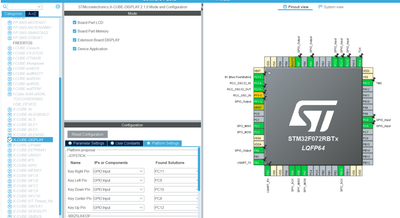

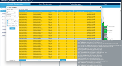

Note: I setup the GPIO by seeing the correct pins in the template of the STM32G071RB with the display, (don't know if it matters to something), by going to "list pinout compatible MCUs":

Exactly M0 isnt supported in MX wizard as showed in list MCU TGFX docu ... min is M0+
