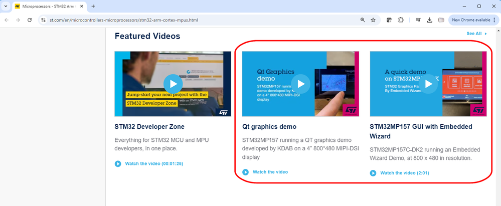

https://www.st.com/en/microcontrollers-microprocessors/stm32-arm-cortex-mpus.html
Correct, the MP1, MP2... That series of microprocessors.
I mean the microprocessor series: MP1, MP2 family. GFX does not currently support these, and I am asking if there are plans to do so in the near future.

Right, we know about those and a few more. The question is about Touch GFX. It does not currently support these micros, but has anyone heard of plans that it may in the near future?
